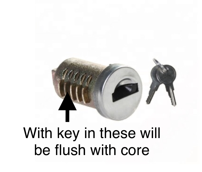

Unfortunately if you can pull the key with it in the “on” position it’s not sticky. More likely it the key or wafers ( tumblers) that are worn. With the key inserted all the wafers align and are flush with the core. That’s what allows it to unlock and turn. Pulling the key makes the wafers rise up and some will drop, as they rake against the key teeth (cuts). With it in the on position they wafers can’t rise as they would hit the outer cylinder. That’s what captures the key. You can try to lube it but it sounds like things are worn.

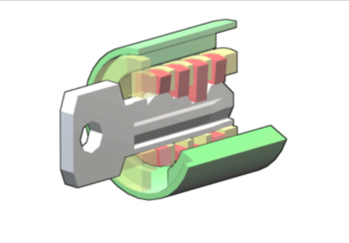

Here’s a good example. The red wafers can not rise or drop as they rake against the key as it is retracted because they will hit the surface of the green housing. When the yellow core is rotated to the off position it aligns with a slot in the green housing that will then allow the wafers to rise or drop and allow the key to be removed. You could try getting a new code key cut. Not a duplicate of yours but one made from the code number on the key. If that doesn’t fix your issue then the wafers are also worn.
