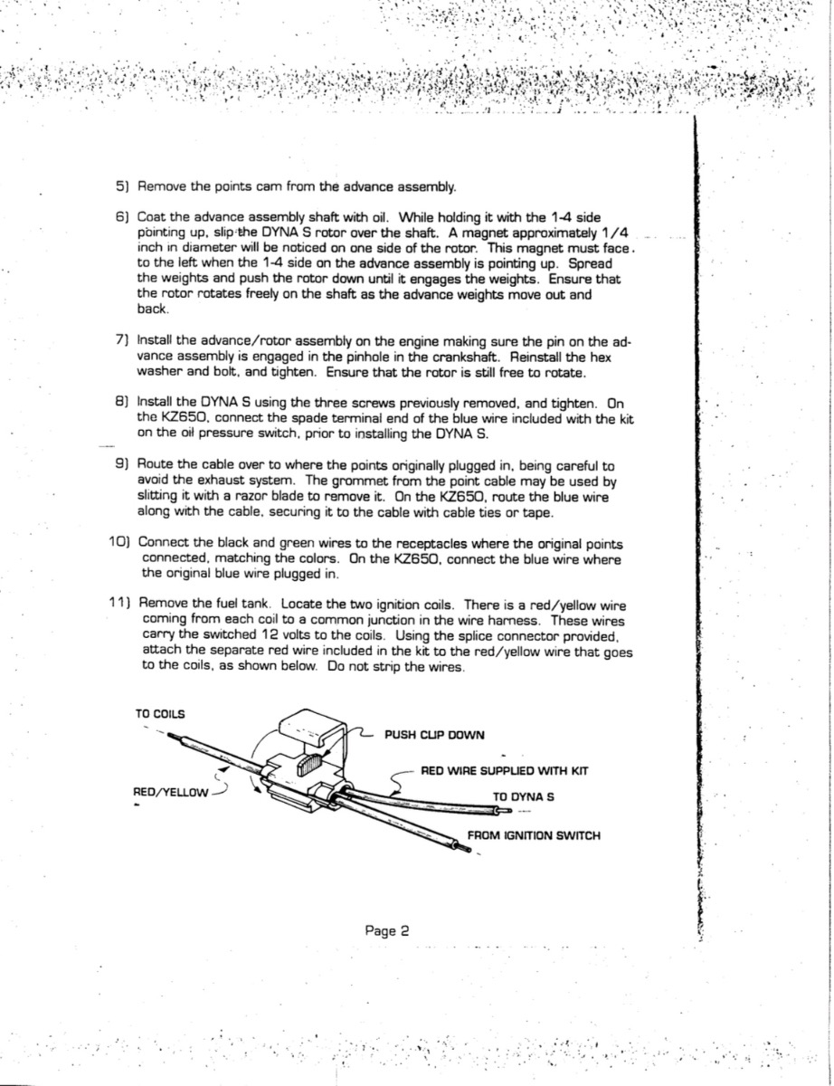

What I'm about to describe isn't the source of your problem but I've had trouble with this in the past. Look at P2 of the information Mikaw posted. At the bottom you will see how the power for the pickup is transferred through a hot connection on the bike via a push clip. That push clip often makes a bad connection, which interrupts power to the pickup. I have Dyna on all my bikes and I attach that red wire from the pickup directly to a hot connection on the bike. On the 900's/1000's there is a spare brown wire near the headstock that will provide necessary power. I'm guessing (but I don't know) there is a spare hot wire on your bike as well.
