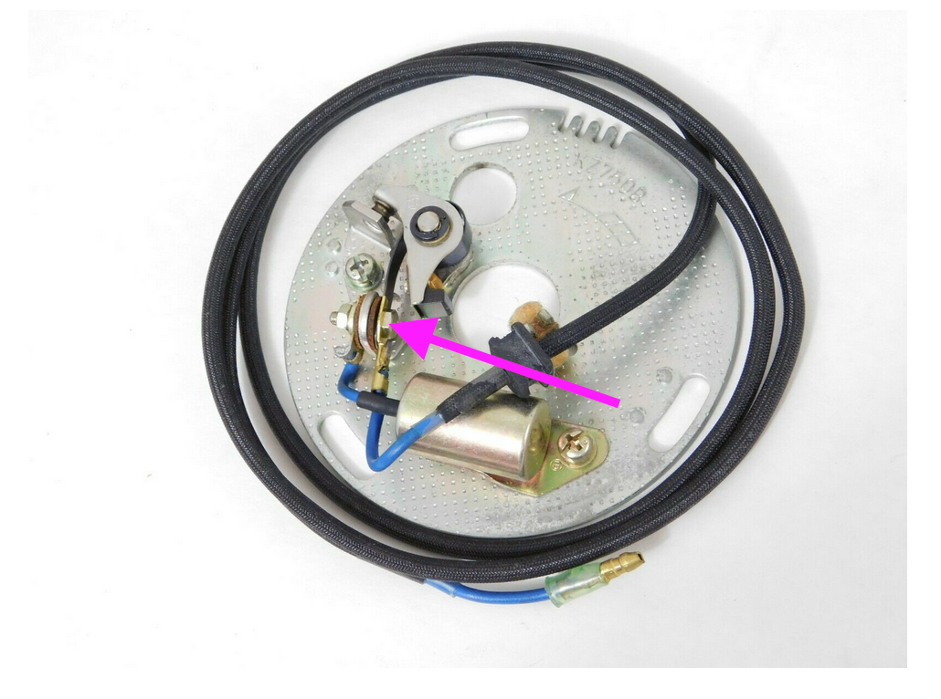

JP,
Get your voltmeter.
Put it on DC V
Ignition on/Engine off
All connectors connected
red probe on positive battery post(post being the metal part of the battery)
black probe on negative battery post
note voltage
rotate your engine till points are closed and put your red probe on the screw indicated by the pink arrow.
note voltage
rotate engine till points are completely open
note voltage
When point are closed your voltage should be below .5 volts. The lower the better.
When points are open your voltage will be close to battery voltage.
Turn off your bike
Did you buy Kawasaki points and condensor?
