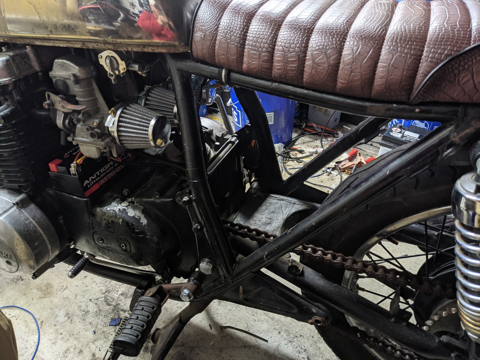

I was out in the garage just looking at the bike trying to figure out a better place for the battery than zip tied to the front end of the swingarm (this was a temporary spot). Then I noticed the gaping hole where the starter used to be. A couple measurements and a few bolts later, the starter is damn near a PERFECT fit in the starter hole. I ended up getting a Anti-Gravity AG-AT7B-BS-RS along with a Rick's reg/rect. I ended up facing the positive out, negative in. Yes, servicing anything electrical will be a pain in the ass, but it keeps the area under the seat nice and clean.

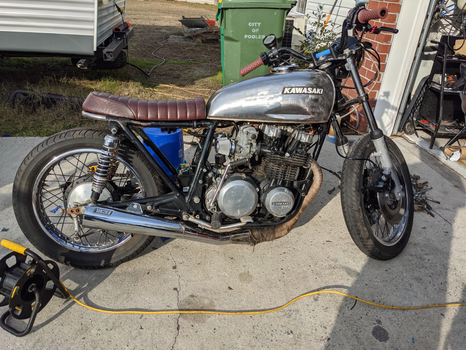

Here's how it sat on Sunday, before moving the battery. Suggestions welcome.

I have three concerns about that battery location: heat, vibration and fuel.
The battery will get really hot there, and will take every vibration the engine and transmission put out. I predict a very short life for it.
Also, any failure of the petcock and float valves may cause fuel to drip or even pour on that hot electrical device (battery). That seems like a really risky plan to me.
A small lithium iron battery under the seat might be a better choice.

11 Jan 2021 20:47TexasKZ wrote: I have three concerns about that battery location: heat, vibration and fuel.
Thanks for the input! The lithium battery is supposed to be very vibration tolerant, so I'm not terribly worried about that. The heat on the other hand, I did think about that but didn't really think it'd be an issue. I'll keep searching for a better spot. I just thought it was a match made in heaven when it slid right in there. I wonder if a heat wrap (that insulated foil tape nonsense) will make a difference? Now that I read the warnings with the battery it does say to avoid prolonged temps over 120.
Well crap. Back to the drawing board.

I'll second the thought of under the seat towards the back.
Do you have to remove the carbs to get the battery out?

Carbs stay installed, just have to remove the cover over the front sprocket/clutch linkage. I might end up going with the super small antigravity battery, but it doesn't have the restart feature or BMC integrated. It will hide nicely under the seat pan.

I also vote for a less harsh location. Under seat is definitely better. Since you are not using a starter, you should be able to use a small battery hidden under the seat. If the bike is 1978 or later, and you are using points, and can wire in some switches for the lights, you might even be able to replace the battery with a simple capacitor. They are much cheaper than batteries. But the bike has to be tuned perfectly and start easily.

Bike is a 1977 B1. In my rewiring adventure I replaced the ignition switch with two rocker switches - one for ignition components and one for lights and charging system. Unfortunately I can't do the capacitor. I'll get a different battery and relocate.
