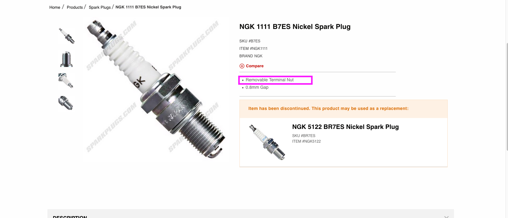

Yeah, you want NGK 1111 B7ES
NGK 2877 B7ES has a solid terminal
photo care of NGK.com
www.ngk.com/search/all?q=b7es

Ok, this proves to be PITA Z1 does not carry those. I got 2 last plugs from local Autozone. Need 2 more and no local stores have them.
Seems like B7ES aka 1111 discontinued?
Re: Is all B7ES plugs the same?
30 Dec 2020 17:14katit wrote: Ok, this proves to be PITA Z1 does not carry those. I got 2 last plugs from local Autozone. Need 2 more and no local stores have them.
As far as I know yes, but not actually discontinued but replaced. The B7ES is now a BR7ES. Resister plug now. I was able to order some through NAPA

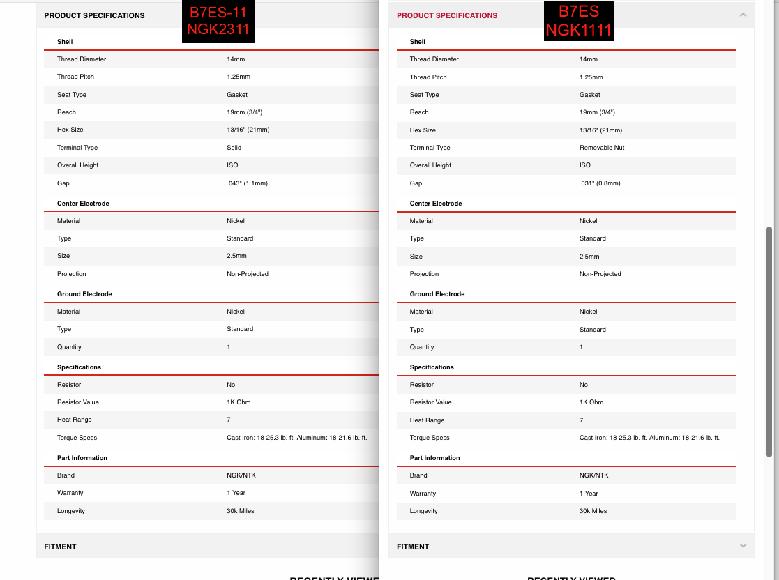

Katit had originally purchased a solid terminal B7ES from ebay.
In that situation a different NGK plug cap would work.
The B7ES is still available but in a larger spark gap version (1.1mm vs .8mm).
You just have to tighten the gap and use a different spark plug cap as it's a solid terminal spark plug.
Part number NGK2311 (B7ES-11)
www.ngk.com/ngk-2311-b7es-11-nickel-spark-plug
table- www.ngk.com/search/partname?q=b7es
01 Jan 2021 10:19
Correct to address the OP. We got off typic chasing plugs as the correction.

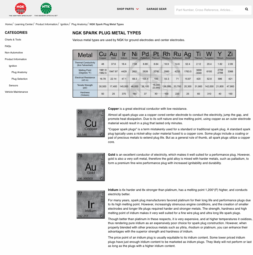

Thank you for finding the replacement non-resistor plug. Why or what is the reasoning to go to Nickle? I also see the 2311 is a solid nut. So to continue to use the NGK we would have to swap in new caps.

I somewhat enjoy the research and seeing what solutions are available.
Mikaw,
Yeah, essentially you would swap caps. They twist on so it's not too much trouble.
Below is NGK's explanation on different metals they use.
Mikaw,
