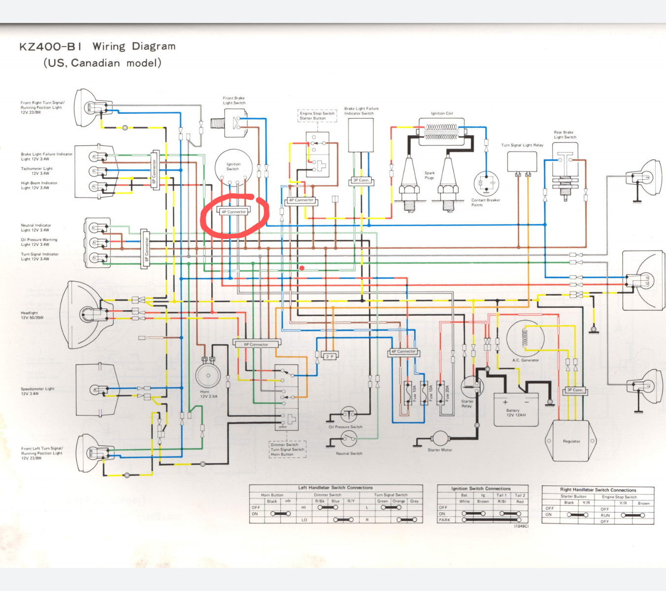

I just cannot begin to wrap my head around this, so any suggestions would really help. I've also attached the wiring diagram if you can think of any other trouble spots I should check for having no power at all.

Your key switch is in between your main fuse and the other fuses. I would suspect something around there.
Turn your key on and measure DC V between battery negative post and the white wire at the key switch.
Then move your positive meter lead to the brown wire at the switch and check the voltage there.
You want close to battery voltage at all those points. It may be half a volt less or close.
When you jumper wired the main fuse with the other fuses it was a clue that you have a break between the main fuse and the other fuses.
You can check these wires inside the headlight bucket at the connector circled in red on the schematic.
Measuring resistance at the switch is not a reliable method of checking it. You can have one tiny strand of wire and the switch will read good when it's actually bad. Corrosion or a bad connection can fool the meter if you use the resistance setting.

Thanks for all the help fellas. I got this problem resolved. There was strange, black corrosion at the very end of the fuse holder (right where it crimps into main wire). So It had charge at the on both sides of the fuse, but not at the very beginning of the wire. Strange how a little corrosion can cause such major issues so suddenly. Thanks for helping rule out the rectifier, I don't know what I was thinking there.
