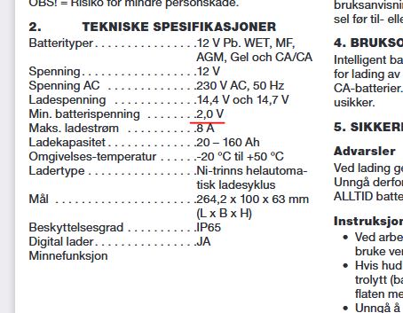

Since you all are so good in Norwegian
www.biltema.no/bil---mc/bilbatterier/bat...-12-v-8-a-2000040408
Minimum voltag - 2 volt
Will I`m able to charge the battery from 0v with these charger ?

For normal 12v lead-acid batteries, once it's discharged to 11 volts all the energy has been removed from the battery. It's empty. If it continues to be discharged, it starts to damage the battery.
A battery at 2V is probably permanently damaged. Even if it recovers it will probably have lost capacity and performance.
A battery at 0v is certainly permanently damaged.
