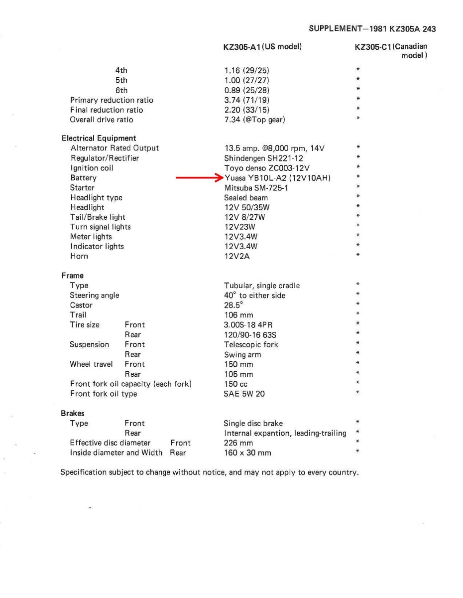

Here are a couple of the Kawasaki diagrams for the 1981 KZ305-CSR from Partzilla.
You can click KZ305-A1 above the drawings for more diagrams.
Also, Yuasa lists the dimensions of the 305-CSR battery. I assume they're correct. see link below.
www.partzilla.com/catalog/kawasaki/motor...ittings-battery-case
www.partzilla.com/catalog/kawasaki/motor...electrical-equipment
www.yuasabatteries.com/battery/yb10l-a2/...ltd&vehicle_id=29181
