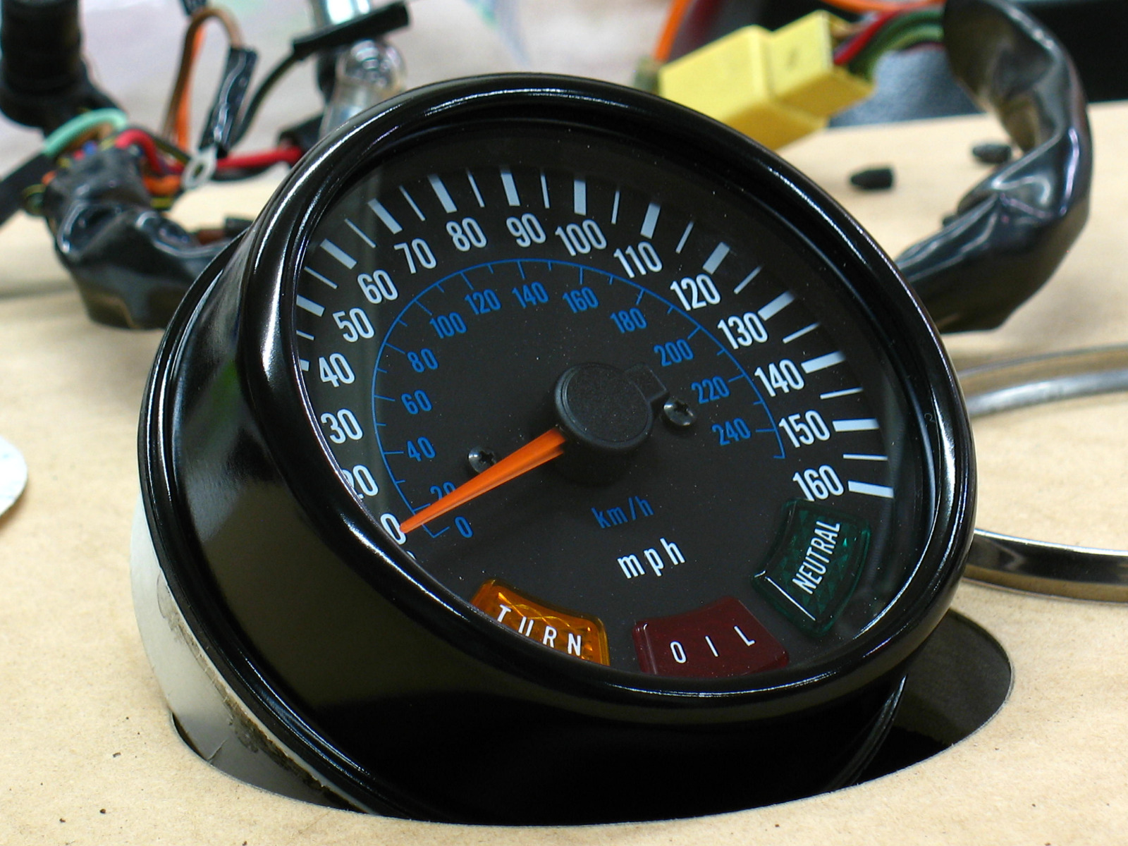

Keep an eye out for one of these...
1982 KZ1100-A2 bike
1984 ZN/ZX1100 motor

My mistake. forgot that his 1000 doesn't have the typical KZ speedometer & he has a different speedo drive unit at the wheel.
ps: the most likely place to check is EB.UK. just about every other country would have used KPH.
