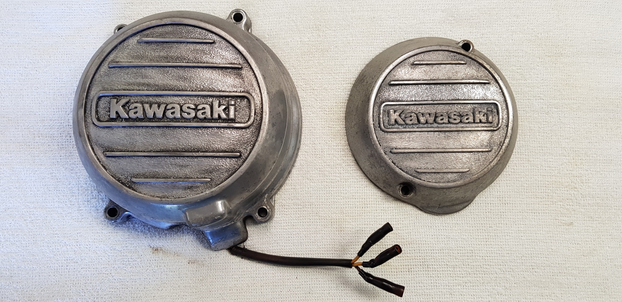

I have a Australian delivered 11/78 z650, I assume the late month on the tag actually means it is MY79.
I really dislike the lower case Kawasaki emblem on the covers and was wondering if there are any covers I can use that will accept my stator and have the upper case logo.
Any help or info will be much appreciated.
Photos attached.

I'm not sure about the alternator cover. I think you would have to swap to a 1977 charging system to use the 1977 cover, or modify something at the very least.
The ignition cover from an earlier 650 should bolt right on.

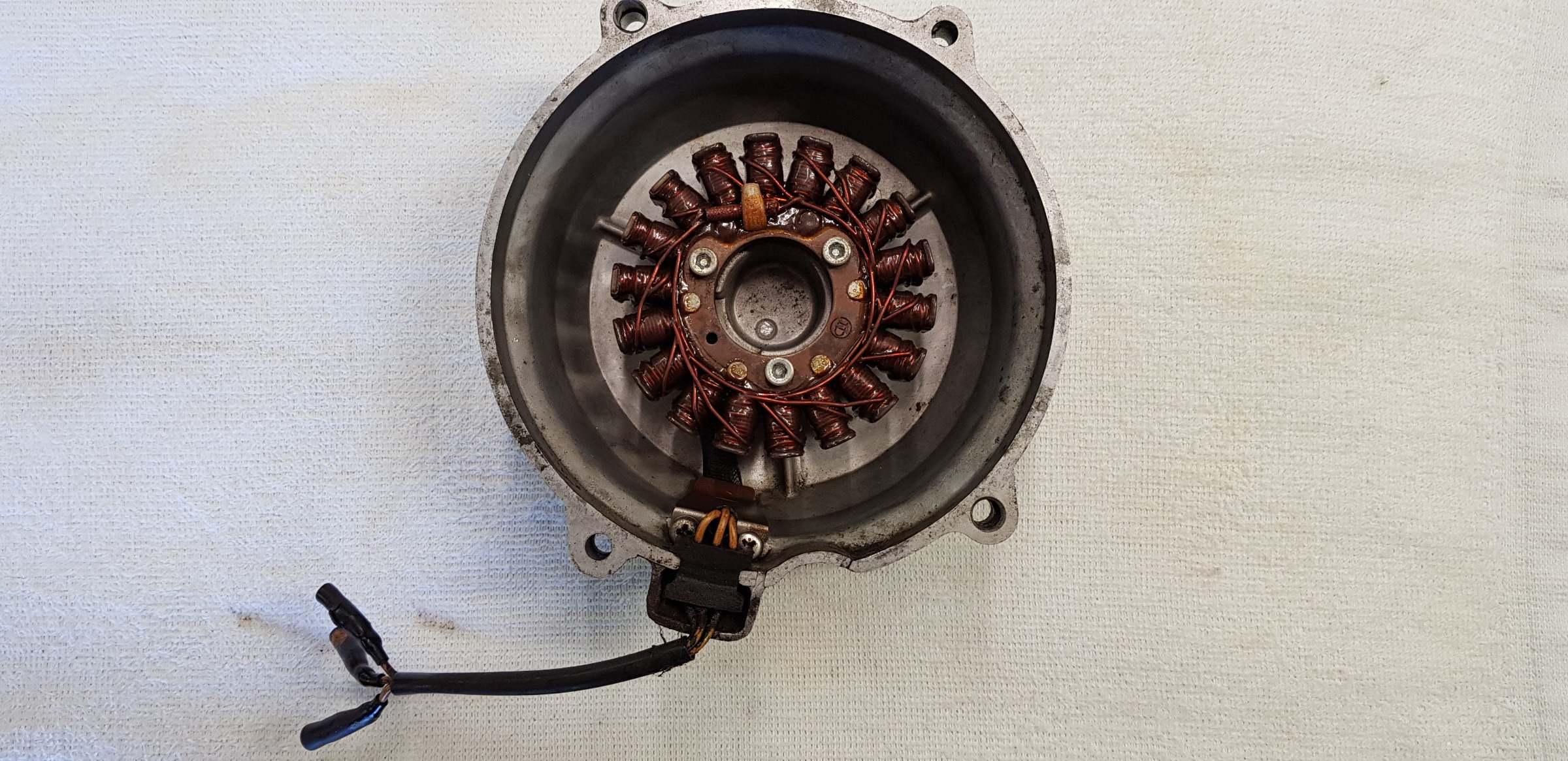

Thanks loudhvx, I was hoping you would answer, it seems some later covers have the upper case logo without the 3 screws but have 2 wire stators unlike mine,
I need to find out the inside ID of a 2 wire stator to compare to mine to see if it is possible, I'll keep researching.

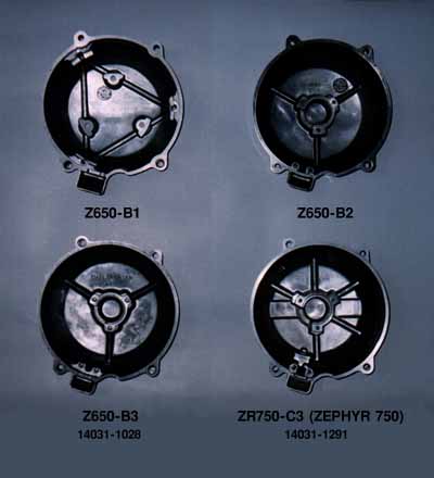

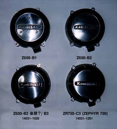

No eBay APP ID and/or Cert ID defined in Kunena configurationNo eBay APP ID and/or Cert ID defined in Kunena configurationNo eBay APP ID and/or Cert ID defined in Kunena configurationThere was a KZ650 alternator/generator cover of similar to early model design and with letters in uppercase but without holes for stator. Here are couple of them:
Breaker cover with letters in uppercase does exist, but it seems to be as rare as unicorn.

Another option is Kawasaki Zephyr 750 covers: they are equipped with removable badges, thus you could make custom badges instead of original. Same is situation with GPZ750 covers.
www.cmsnl.com/kawasaki-zr750c3-zephyr-75...121868/#.X46O2HVS-Ul
www.cmsnl.com/kawasaki-zr750c3-zephyr-75...311291/#.X46PY3VS-Uk

Thanks gazzz, I just went out to the shed to look at my alt cover and I think the first one you posted would probably work with my stator, the casting looks to be identical, enough for me to take a punt on I think. I will search to see if I can find one in a bit better nick than the one you posted and see how it goes.

No eBay APP ID and/or Cert ID defined in Kunena configurationThe 83 650-CSR engine covers are similar to the Zephyr. and a few other models had the same covers. see cross-reference at Partzilla.

The use of capital letters on the alternator cover was used on the 77 and 78 models, in 79 and later they were not . I have not done so but think you could use one from 78 with your current system. I have attached a couple of pics showing the outside and inside of the covers. Hope they help.
