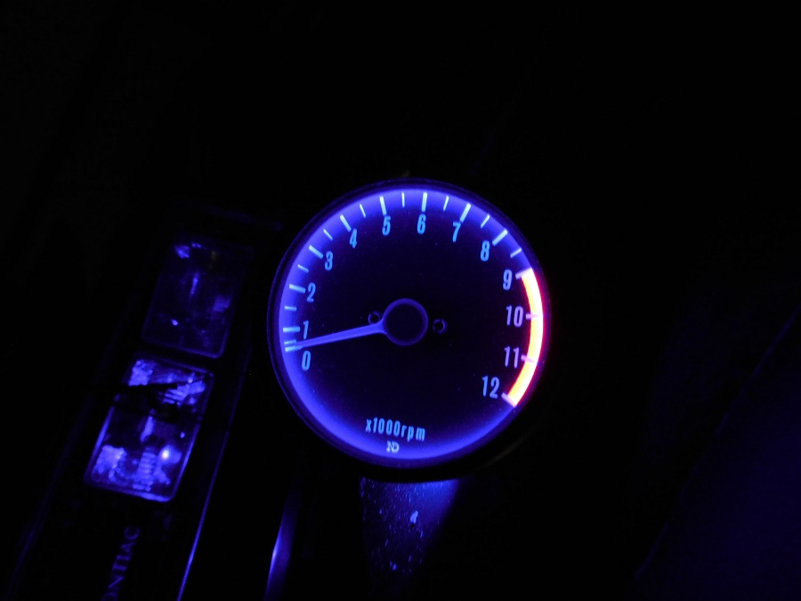

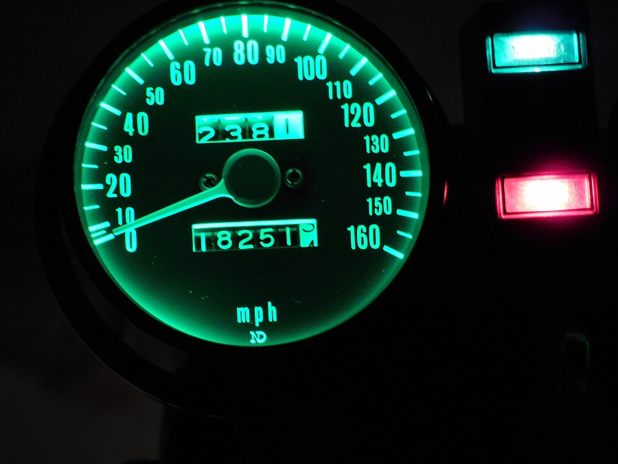

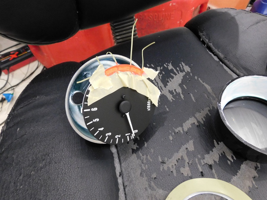

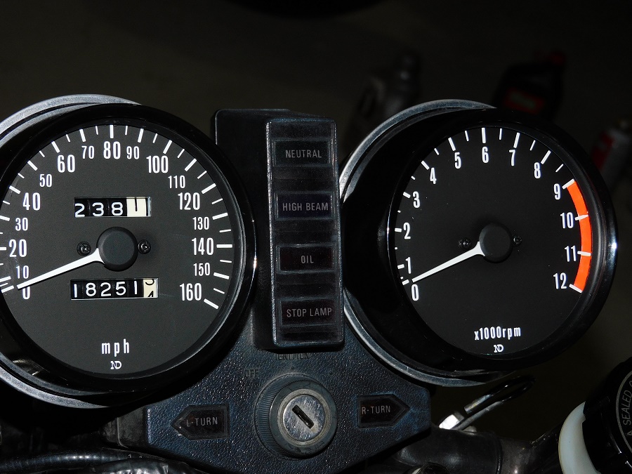

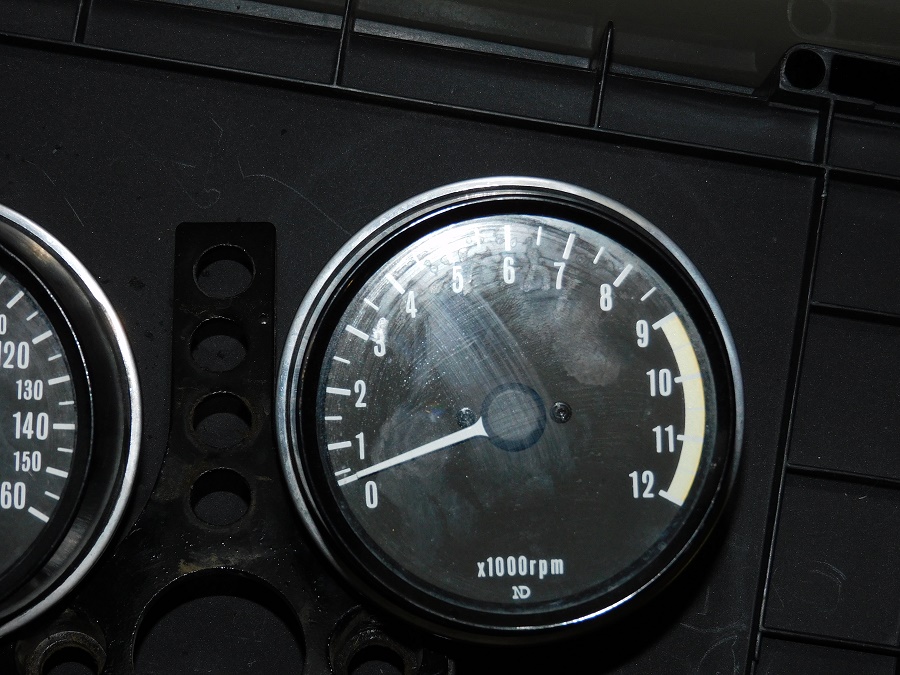

I hate how faded and dirty gauges look. I tried a reproductions set on my 900 but found the tach response to be kind of slow so I thought I'd try a little clean up of the factory ones that came off the bike. It was pretty straightforward. I used new crimp rings rather than reuse the originals. I painted the light baffle flat white so I could play around with different colored lighting. The two shown are green LEDs and Ultra Violet LEDs. I've got a set of red on order. I did cheat a little bit by not keeping the 500 rpm increment hash marks in the redline. I was afraid that a poor result would look worse than just skipping the little buggers. One photos is of the "before" and those streaks are on the inside of the lens.

Nicely done. I prefer the green to the blue.

Me too but I think red is going to be good also.

Beautiful job!
I also vote for green.
Blue/UV Led's are not something you want to be looking at. Plus UV will fade things. That said, UV led's put out very little actual UV, just mostly blue light.

Nice rebuild!

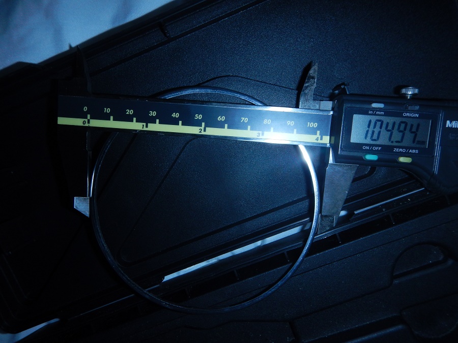

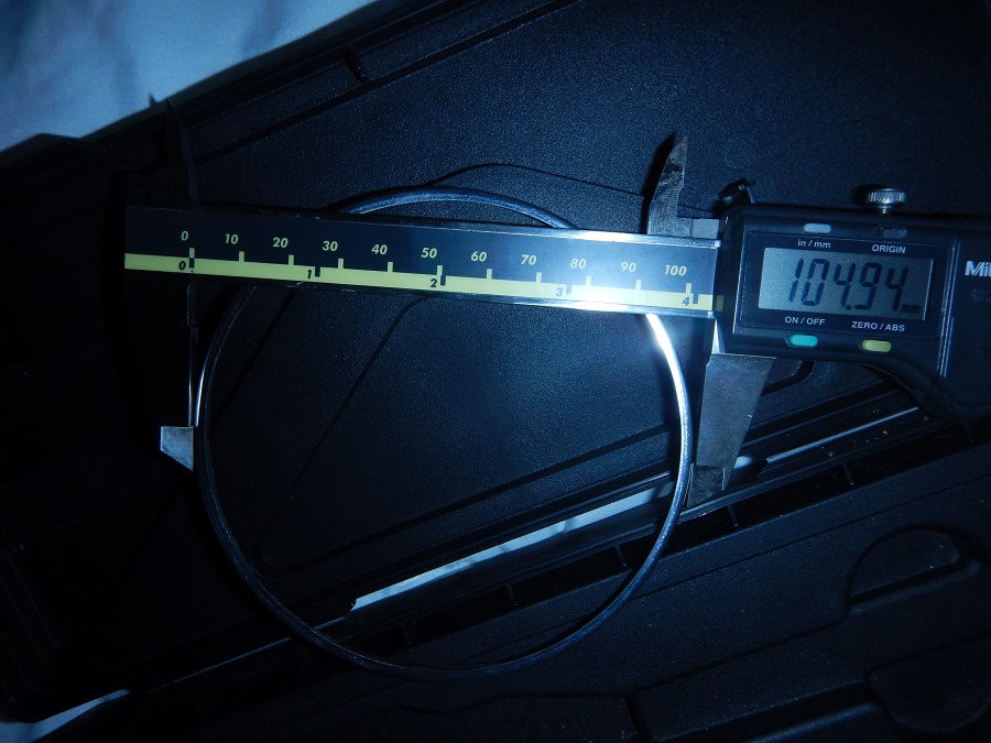

Thanks for the link RBRKZ. My 550 D1 isn't listed as a model that those rings will suit, however they do "look" similar. I measured the rings on my 550 at 102.5mm . I would appreciate it if you would confirm what diameter yours are?

I couldn't get a direct measurement from a gauge but the rings that I took off are pretty close to CB750faces listed size of 104.5mm O.D. Mine may have stretched a bit from being removed.

Thanks a lot!
I believe they will work fine.
I will order those.
