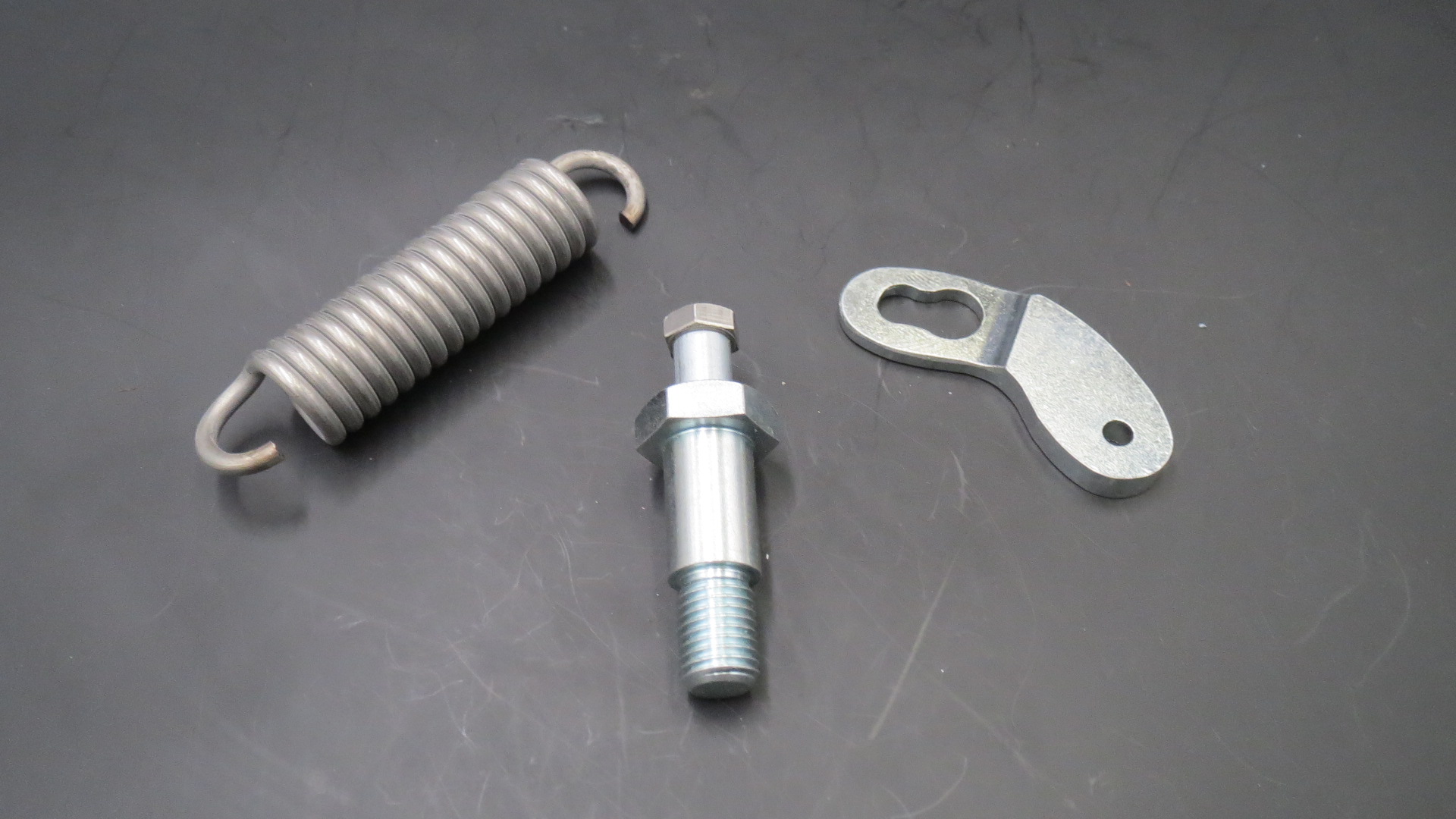

19 Mar 2021 13:49 - 19 Mar 2021 13:55I had the same problem here in Germany, it´s not a sidestand switch problem, but i have to upgrade to a self collapsing mechanism to pass the bike inspection.Sorry, its a long timer ago already, the dyna S is mounted and the bike is running.
Unfortunately I had from the beginning a problem: the main fuse broke several times, until I remarked that it has to do with my sidestand switch. I have four wires on it, two black ones to go to the start button, and two others to go to the left handbar where I have a button to Interrupt the "interruption", means that if I pull the button, the bike remains on when the side stand is out. The wires to this button on the left handbar became extremely hot before the fuse broke, and only after I pulled out the wires, I can drive, but the side stand switch does not function anymore. And now, to come back to this little box I through out, you remember, see picture above, this was the relais for the side stand switch!! I remarked it after I passed through the wire diagram of my Z11000ST Swiss Version. I know that the US and UK version does not have this side stand switch!?
The problem is that with the connection of the Dyna S, I cannot use anymore this relais, and I must have a another one when I want that my sidestand switch works, and for the vehicle inspection here in Switzerland I need a side stand switch that works; alternatively, I take away my side stand, or I install a mechanism that the side stand collapses itself - sorry my English, I am not sure you understand what I want to say.
z-fever.de/shop/en/product_info.php?info...and--automatic-.html
Last edit: 19 Mar 2021 13:55 by Scirocco.

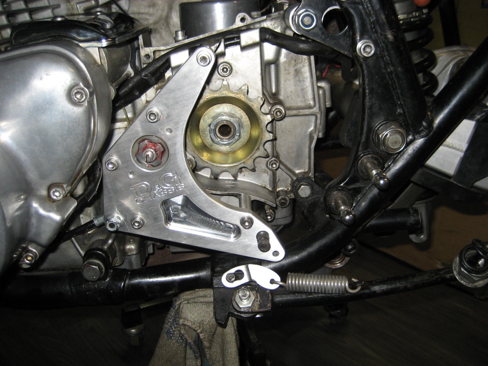

I bought the same kit from Z-fever, but wasn't successful mounting it so fare. Do you use only the metal pad, and the spring and where the pad is mounted is original? the nose where the pad is mounted is where before the spring was mounted correct? The screw from the kit should replace the main screw to mount the stand isn't it, and my original side stand screw is much wider.
- Posts: 4420
- Thanks: 2270
Re: Installation Dyna S ignition, Dyna coils and plug leads Z1100ST
20 Mar 2021 12:42
Some pics of your side stand would be helpful to solve your problem. Your original side stand screw is much wider but can be modifyed to work with the kit.
