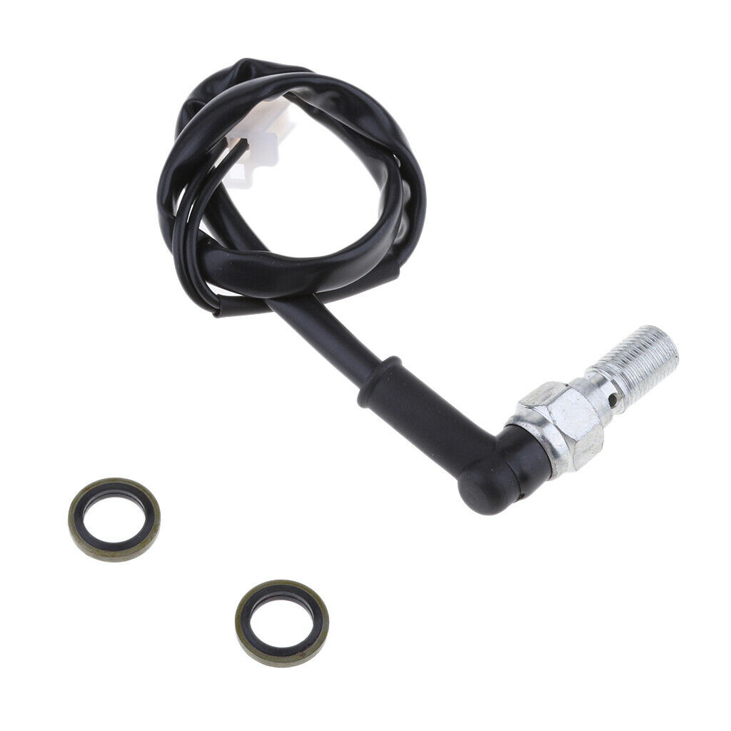

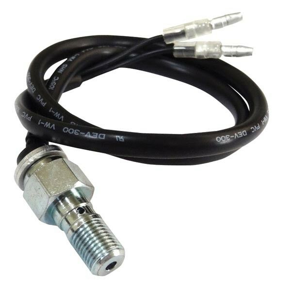

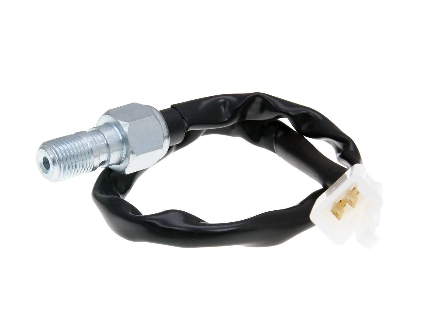

Buy a hydraulic brake light Switch, they last forever. They are available in M10 x 1,00 and M10 x 1,25 for single or double Banjos.
