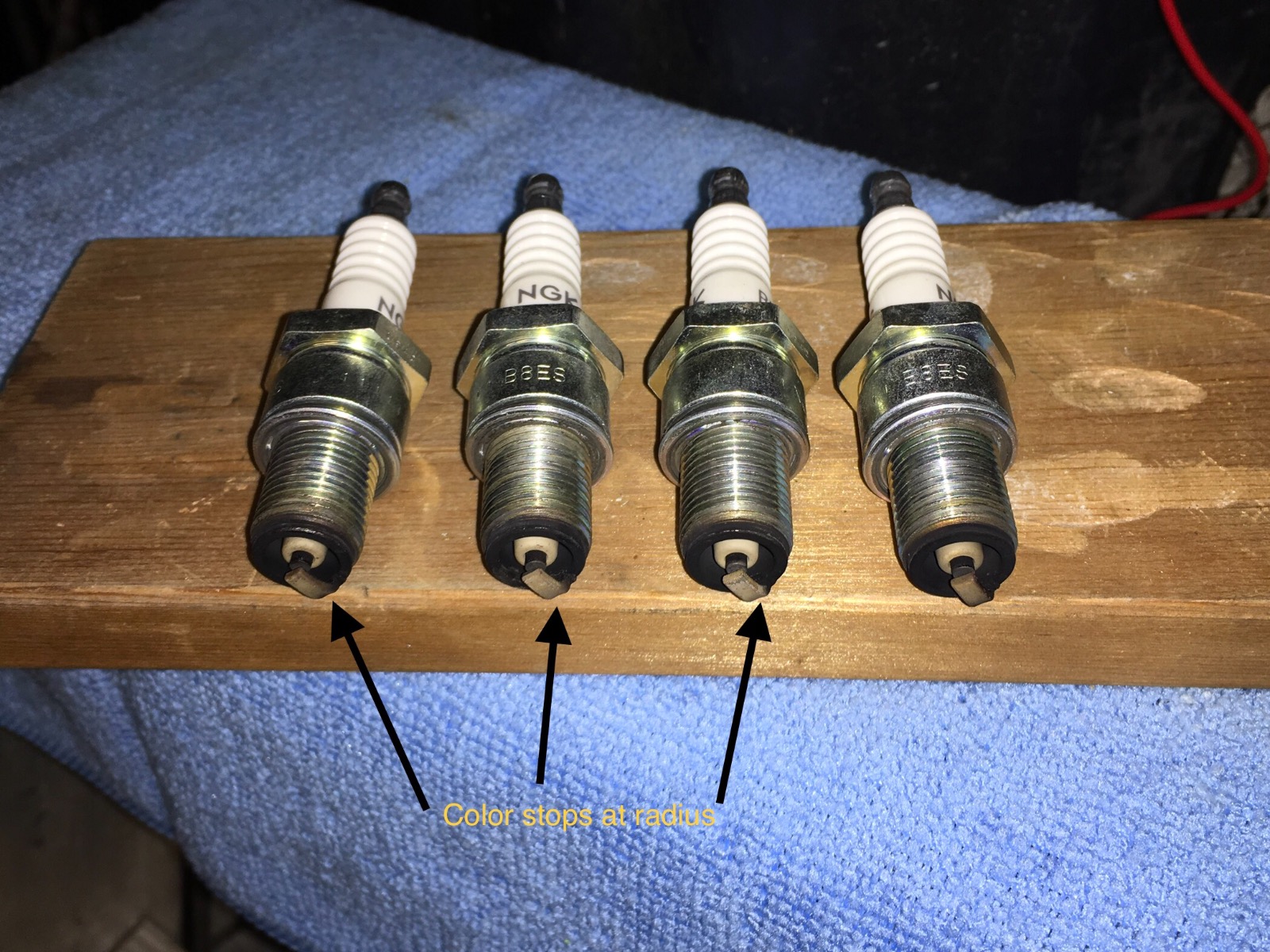

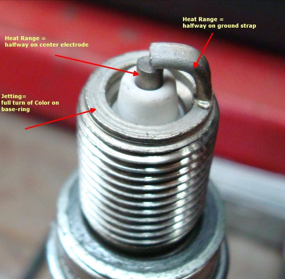

From what I have learned about reading plugs is, the temperature range is determined by looking at the earth strap. There will be a color change from a gray to black. If the point of change is close the the tip it’s to cold. If the color change is near the bend it’s in the correct temperature range, and if there is no color change or it’s at the point where the earth strap is welded the the base ring then the plug heat range is to hot.
Last edit: 03 Sep 2020 21:03 by Mikaw. Reason: Added photo
Re: Wrong spark plugs
03 Sep 2020 21:10
Here are my plugs from a few months ago you can see the color change on the earth strap. I agree with 650ed. You need to look at tuning as the problem. White plugs are a result of a lean condition. Heat range will not correct for bad jetting or timing.
