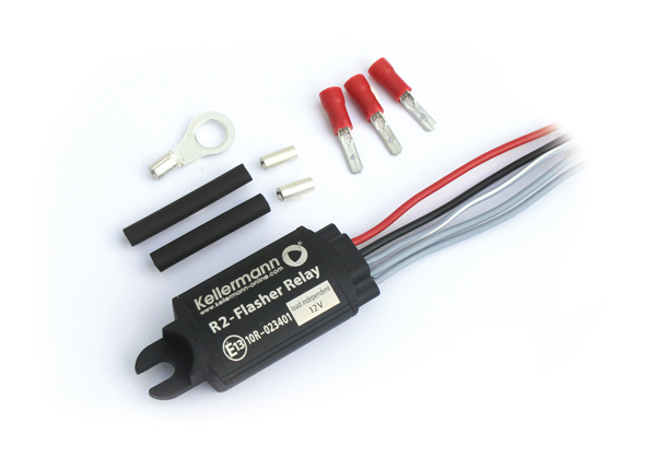

The Problem is, you need a electronic flashers relay and If you have only one turn signal indicator bulb for the L/R signals you need a diode recifier.
Kellermann offers a LED flasher relay that did both functions in one device.
www.kellermann-online.com/en/products/el.../68/flasher-relay-r2
