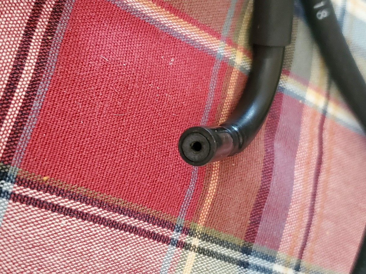

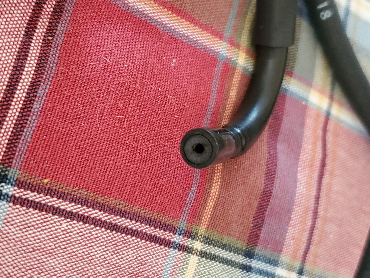

I have a stock coil which has the screw caps and a little pin sticking out of it. Below is a picture of how my stock wire looks:

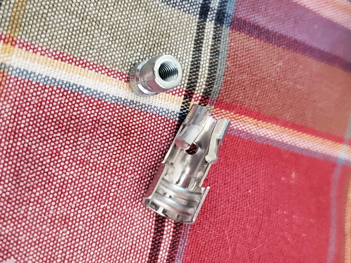

So as I said before, the wire has to slip into the coil. The kit came with end attachments, but both of which do not appear to be compatible with the coil:
So either I'm missing something, or I have to ask it again... where can I get spark plug wires for a 1984 GPz 550?
