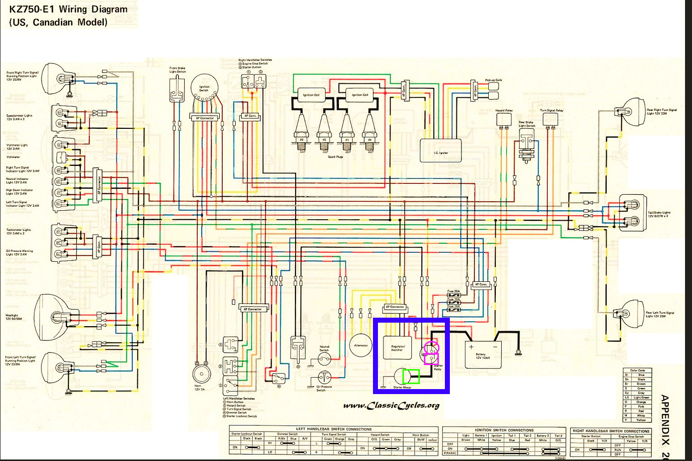

we'll go through some voltage drop tests in a couple of hours.
get your meter ready
You may need an extra set of hands or alligator clips to hold the probes in place.
set your meter to DC V
ignition on/engine off
Turn off the fuel valve.
Black probe on battery negative post( the post will be the metal part of the battery not the metal part of the battery cable)
Red probe on battery positive post
Note voltage
Crank starter
Note voltage
Black probe on negative battery post
Red probe on starter terminal in green square
Crank starter
Note voltage
Red probe on metal part of starter case
Crank starter
Note voltage
Turn off ignition
These readings will check your battery, your wiring and starter.

This looks like it's either the battery or the starter motor itself. You can test the battery and starter following F64's steps, but if you don't have a multimeter, you can just test it with a spare battery too. If you connect up a spare battery (car battery is fine, but don't start the car) and it cranks, it's probably the battery that's gone.
Keep in mind that the battery box is often isolated from the rest of the frame, so make sure that your battery ground is connected to the frame, not the battery box. I fixed a KZ250 that wouldn't start without jumping even with a new battery, turned out it was the battery was grounded to the battery box and the only connection to ground left was a small ground wire that ran to the gauges I think. The small wire was enough to keep the bike running, but not enough to start it.

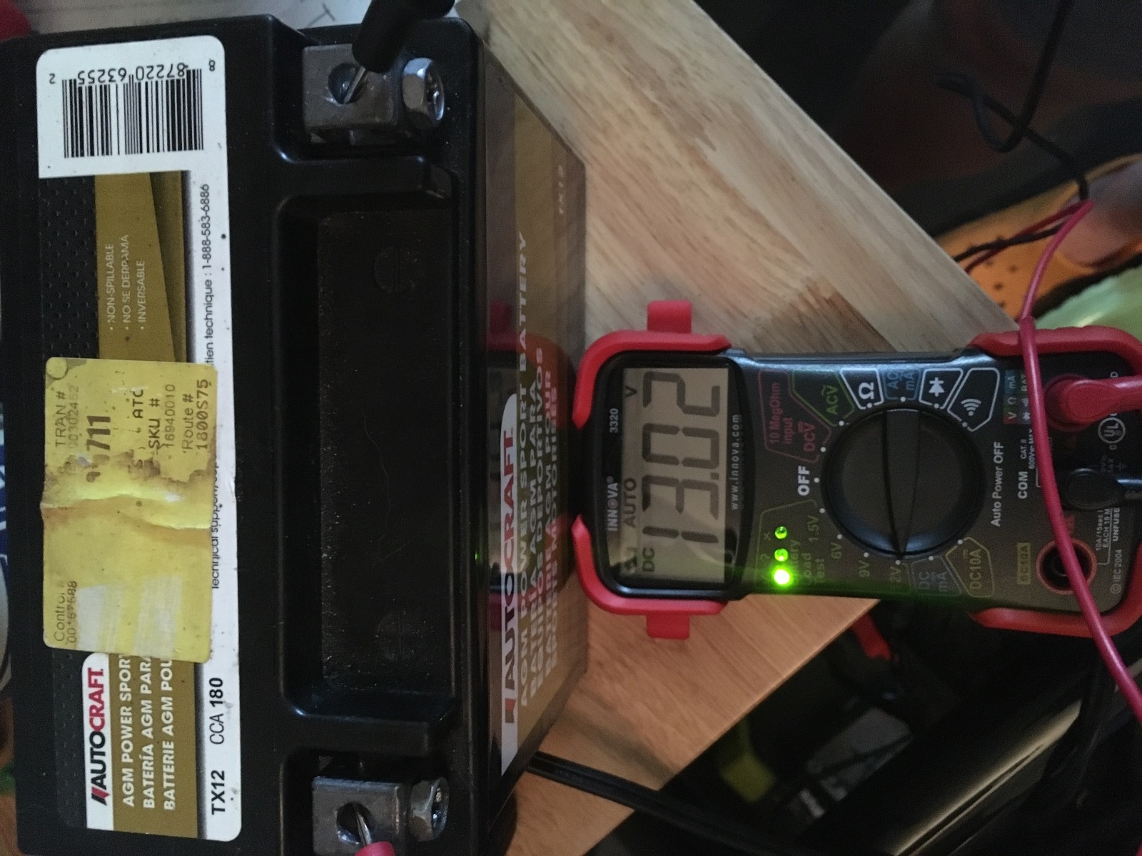

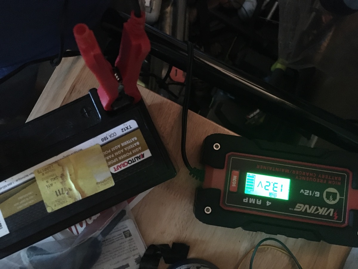

F64 thank you very much for expanding into detail those testing steps - I really appreciate it. When I have the time and/or hands to run through it I will let you know what I find.
I just picked up a multimeter but haven't gotten into using it yet. I pulled the battery and put it on my charger but for some reason it was saying it was fully charged (lit up green) at only 13.6. Manual says it should read at 14.5 across the terminals?

14.5V is probably with the bike running at a specified rpm (idle, 2500 rpm, etc.) The charger is probably putting out 13.6V. What does it say with the charger disconnected? It's best to do a continuity check on the glass tube fuses. Sometimes they break at the end caps and it can be hard to see that.
