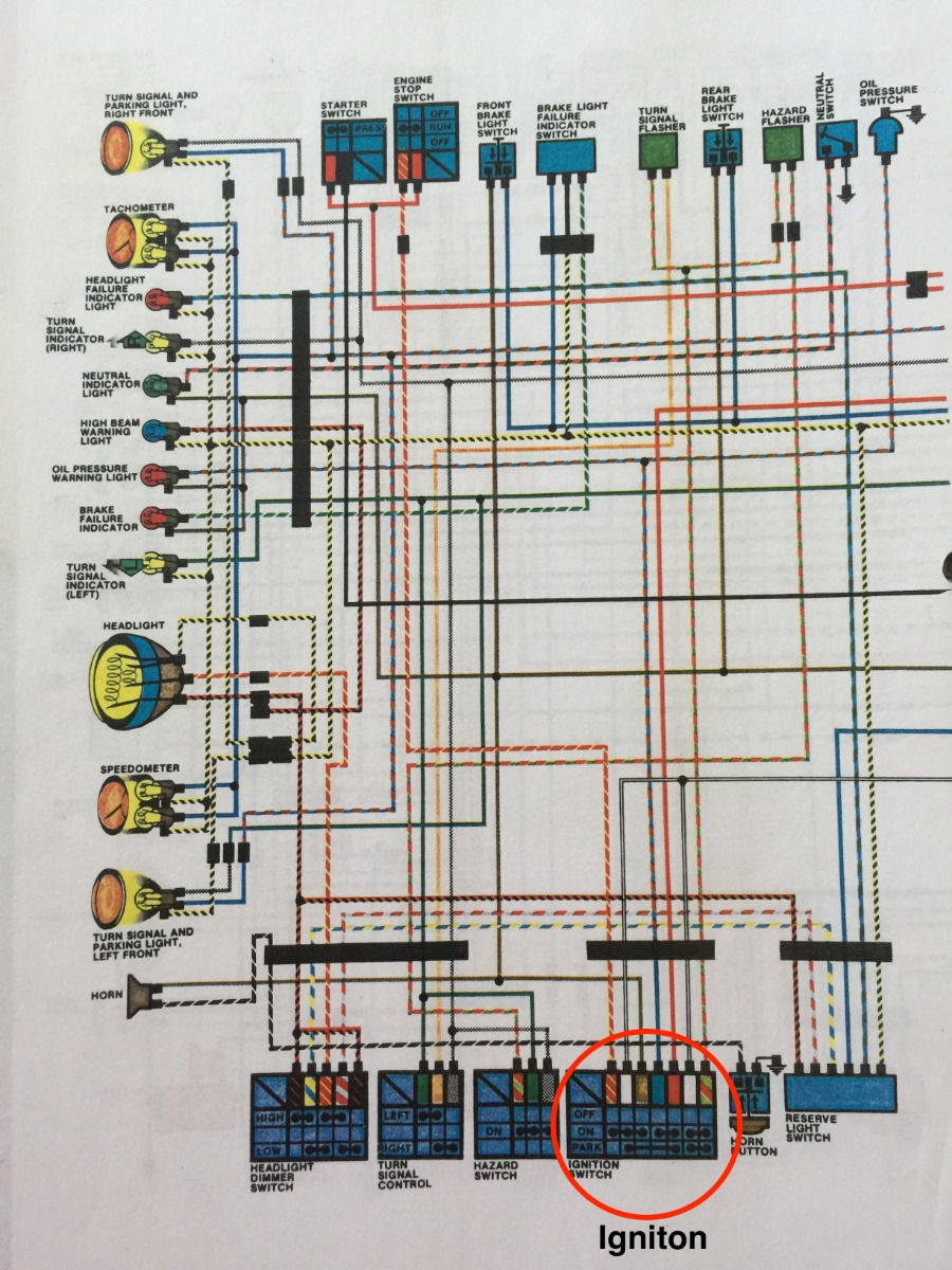

- Posts: 3136
- Thank you received: 1235
27 Jul 2020 17:51 - 27 Jul 2020 17:53 #831658
by hardrockminer
Replied by hardrockminer on topic Wire colors coming out of the ignition...meaning??
There should be 7 wires coming out of the switch with 6 going to the plug, and a black one going to the horn. See attached photo of the wiring diagram below. I've hilighted the switch. The colours on the diagram are what should be coming into your switch. Apologies for mis-spelling ignition.

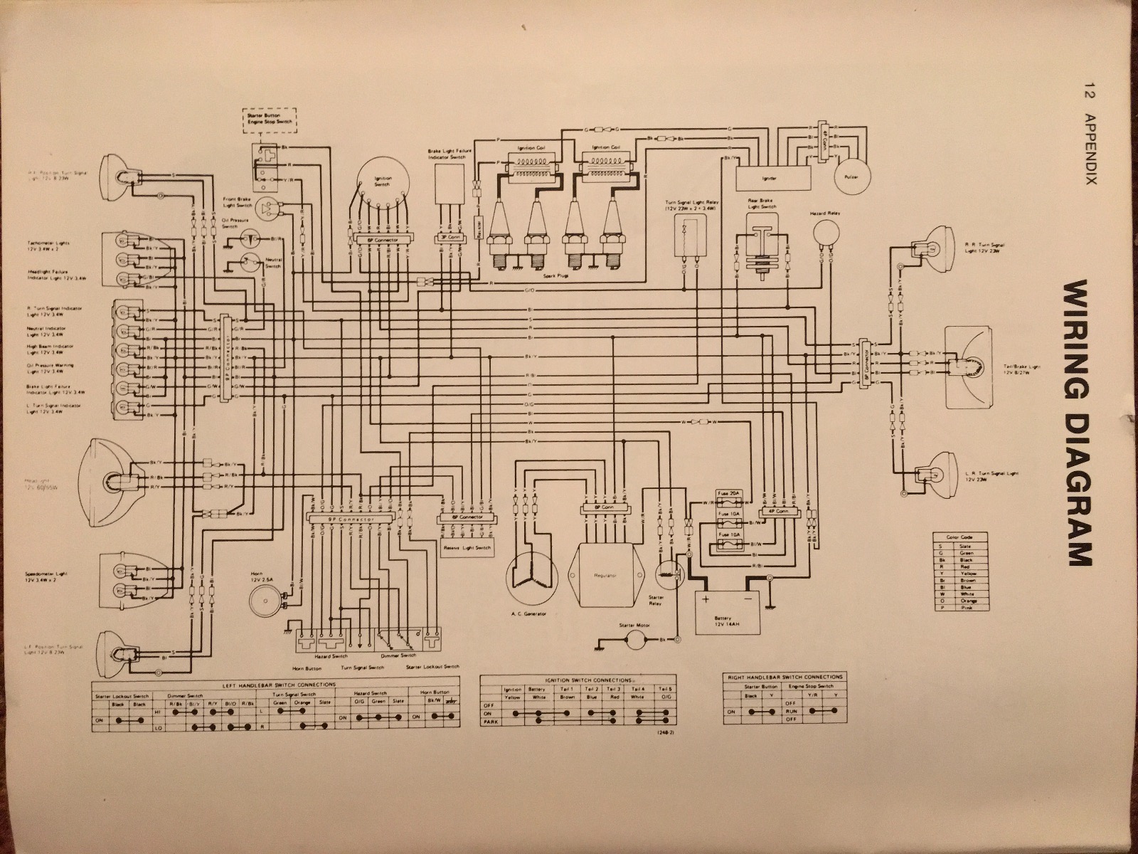

- Posts: 79
- Thank you received: 11
27 Jul 2020 18:02 #831661
by Tirefire Pat
Replied by Tirefire Pat on topic Wire colors coming out of the ignition...meaning??
Stock ignition pic

- Posts: 1160
- Thank you received: 419
27 Jul 2020 18:03 #831662
by F64
81-KZ440-D2.
LIC, NY
Replied by F64 on topic Wire colors coming out of the ignition...meaning??
connect yellow with brown
Look at the "on" section of the chart in the green square.
When you switch the bike on, the white power wire is connected to the brown and the yellow.
