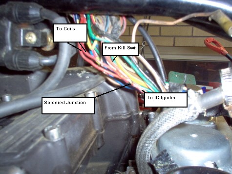

If one red coil wire has power then the other should have the same.
Click the filebase tab above and search for "750" and you will find several wiring diagrams.
Power for ignition comes from battery to ignition switch to kill switch on right handle bar cluster to the main harness under the gas tank where there should be a soldered junction with 2 red wires going to coils and one red wire going to ignitor. If one red wire does not have power then there is likely a break. You will have to cut back the harness covering and repair. This junction will be close to where the wires from the right handlebar cluster enter the main harness.
See photo below
See photo below
