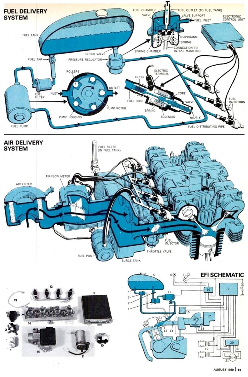

My guess on your wire coming off the head is a prehistoric heat sensor for the ancient fuel injection system.

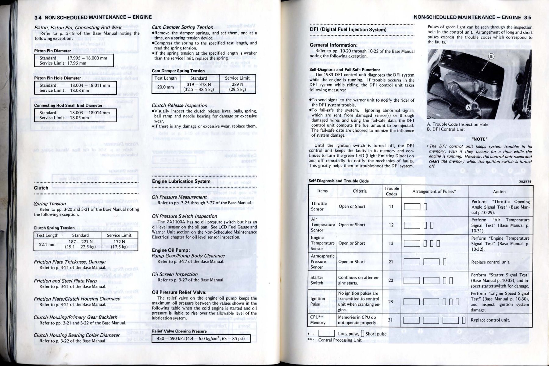

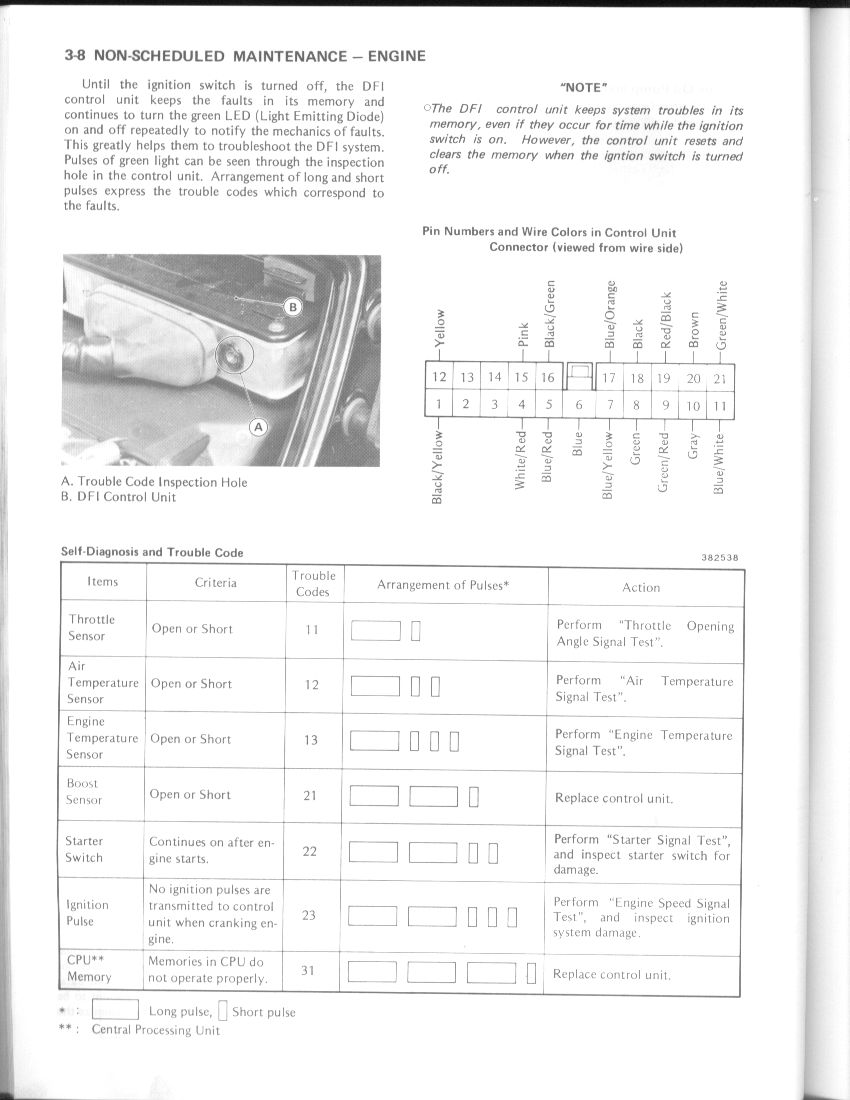

Those 1000 classics were some "mad science" as far as I was concerned "back in the day". Even then they had a self diagnostic feature where they would flash a code. I just found a slip of paper going through some old crap that is the error codes in Japanese that someone had translated for me.

Re: 1980 Z1 Classic wiring HELP!
12 Jul 2020 02:29
The KZ1000 Classic and the European Z1000-H Fuel Injection bikes didn´t had any self diagnostic feature in the ECU.
The next gen DFI models like GPZ750 Turbo or GPZ1100 UT (ZX1100A) had a self diagnostic feature in the ECU.
12 Jul 2020 05:20
The picture of "the trouble code inspection hole"(funny name), looks very familiar. My memory must of been of the 750 Turbo, THOSE were cool bikes! Your knowledge is impressive!(apparently more so than my memory!)

Thank you all so much for the replies! Those pictures of the way the fuel delivery works are super cool. I’ve been running the bike with no problems so far with the wire just hanging there so I’m not losing too much sleep over whatever it is. I’m definitely glad the PO swapped to the VM26 carbs as they’re much easier to work with lol. I’ve slowly but surely been able to tackle everything this bike needed and now it’s just a matter of jetting the carbs (which I was able to figure out after some research). All that’s left is swapping all the blown speedometer and tachometer bulbs, throwing some stainless steel front brake lines on, and changing the oil and it’s ready to ride after that! I’ll get some pictures posted up here soon. Maybe I’ll have to send them to my computer first :silly:
