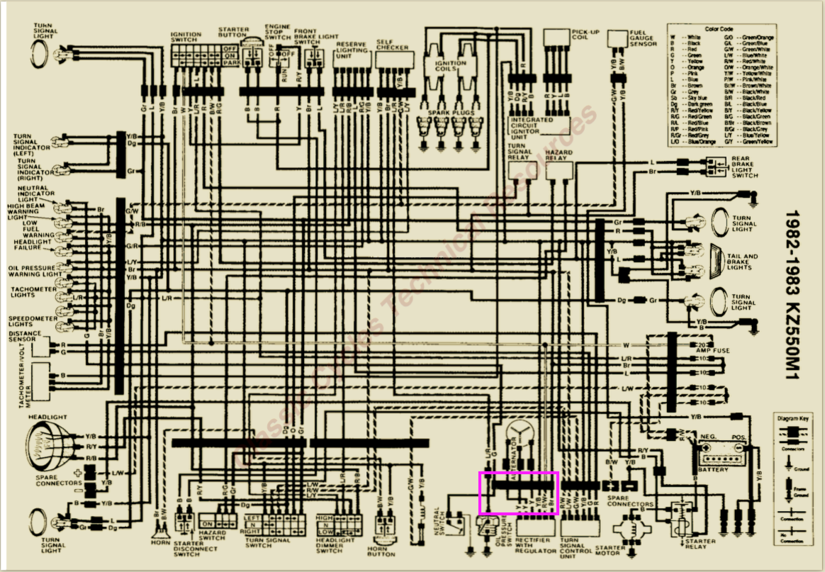

and....you don't have a cdi...just an ignitor. I just found that out.
which is fine.
I'll probably just run through some voltage checks to see if anything looks strange.
Grab your meter
Checking battery voltage
Bike running
meter to DC V
Red meter probe--Positive battery post(the post will be the part the battery cable attaches to)
Black meter probe--Negative battery post
Note voltage
Checking charging voltage at idle
move Red meter probe--Red/White wire out of voltage regulator(pink box)
Note voltage
Checking charging voltage at 4k
Raise rpm up to 4000rpm
Note voltage
meter to AC V
Checking for AC ripple out of rectifier
Red meter probe--same wire(Red/white wire)
Black meter probe---Yellow/Black wire(in the pink box--same connector as the red/white wire)
be careful--don't let the probes touch each other
raise rpm to 4000
note voltage
photo: www.classiccycles.org/
which is fine.
Grab your meter
Bike running
meter to DC V
Note voltage
Note voltage
Note voltage
meter to AC V
raise rpm to 4000
note voltage
