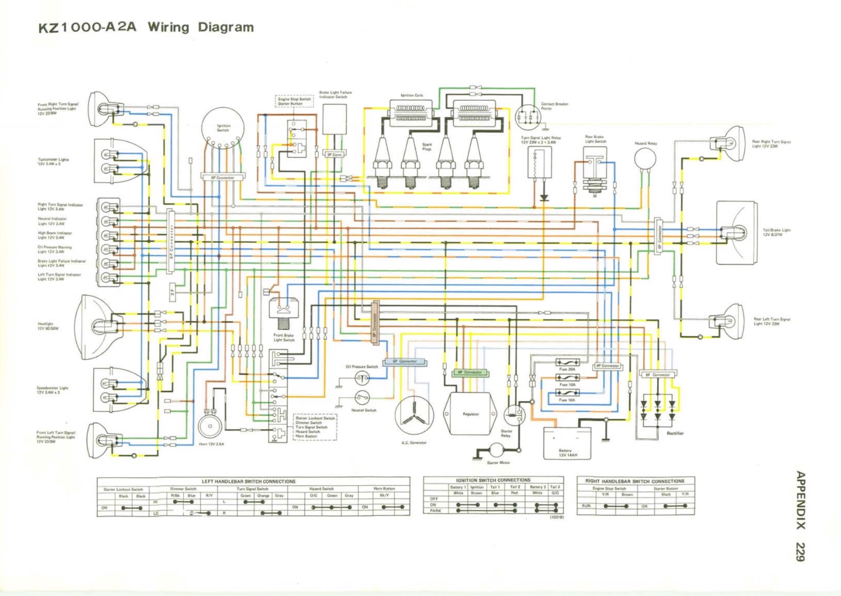

Re: 77 kz 1000A1 Loses spark and dies along with lights and button start after 20min
29 Jun 2020 11:51
The following user(s) said Thank You: F64
29 Jun 2020 11:52
- Colecarv
- Posts: 18
- Thanks: 2
29 Jun 2020 13:36
So now that I have a schematic
And nailed down that the battery is definitely not charging; what is the first test I should make on the modules/wiring?
i know the blue plug feeds from the generator, mine is phase sensitive as its an early model A1 (pink blue yellow).
I had lengthened the wiring of the blue plug to snake up under the seat as I have hidden the electrical under t he seat. which wires can I probe in order to find out of the generator is in fact making electricity that (would) get to the regulator and rectifier ?
