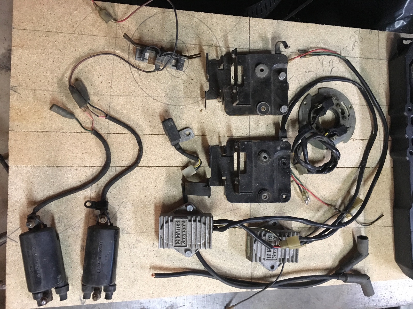

Hey if itsworth trying I have a breaker plate with pickups that did work... the old worked great when parked statement... I’d ship Them to you for a test...

Mikaw, thanks for the offer. What you are showing looks like what I have now, except you have two igniters. I may take you up on one of the igniters but am still messing around with the coils and plug wires to eliminate them as suspects. Once that's done I'll move back one step and check the resistor, then the igniter.

HRM, anything in that picture you need is available... all that ignition is from a 1979/80 correct? I can’t see having any need for them... I have no plans to build a correct bike that year... if you’d need to change the connectors in the igniter I’m ok with that...
