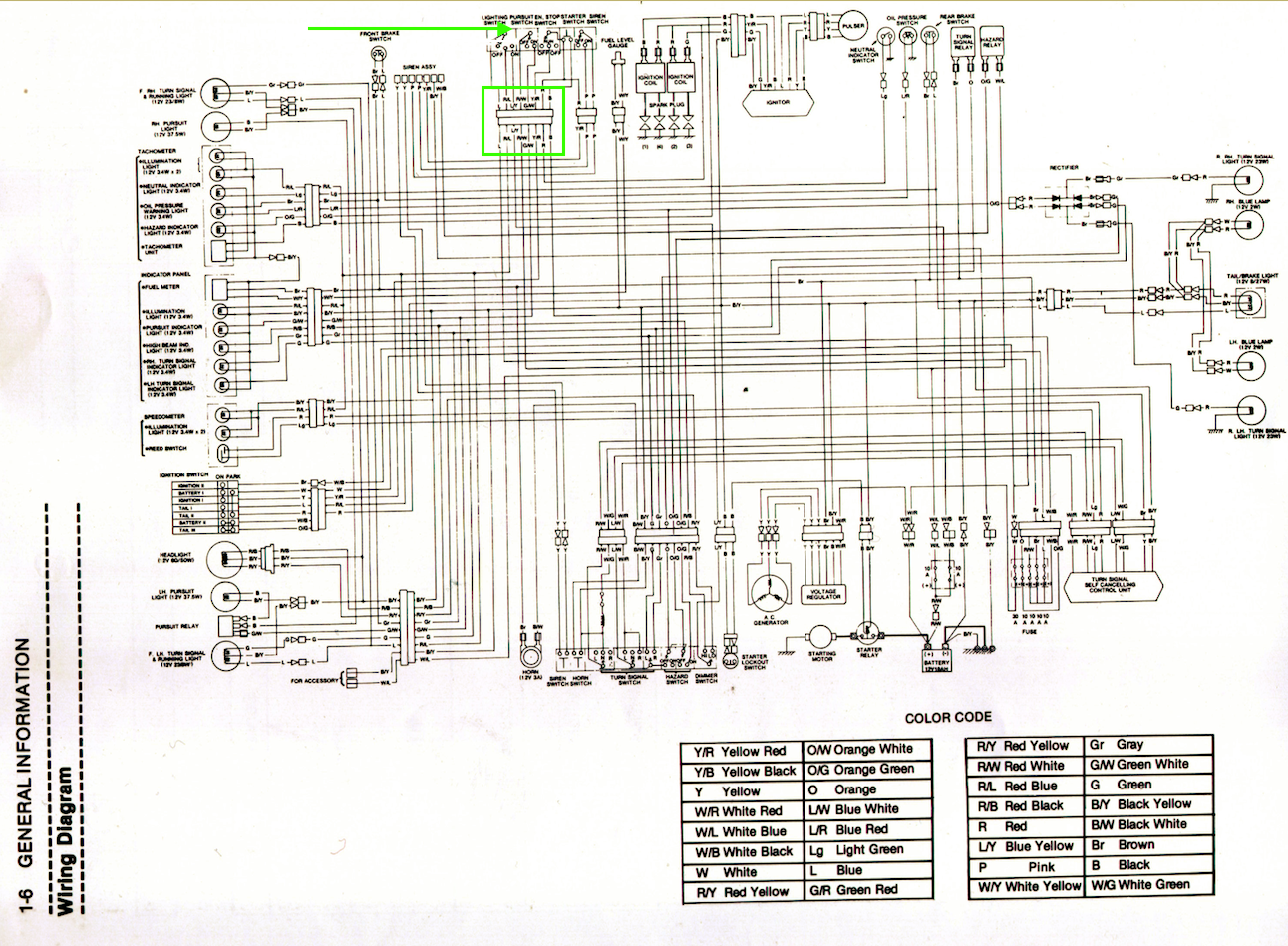

I'm hoping someone can point me in the right direction. The pursuit lights on my 2001 kz1000p are always on regardless of switch position or if the bike is on or off. Thanks in advance!

I would disconnect the lighting connector at the pursuit switch. Then check the operation of the switch with the meter.

There is a "pursuit relay" . You can see it in the lower left corner of F64's diagram. If you pull it out, theoretically the lights should go off. ...unless somebody was fooling around with a soldering iron etc.
It's not really a relay from what I can tell. It's drawn just as a simple splitter for the power. Maybe it's designed to alternate the lights. There is no independent source of power going to it, so disconnecting the connector at the switch should also kill the lights, like F64 said. The green/white wire is the one powering the pursuit relay, but it is also coming from the pursuit switch, so it should be dead when you turn the switch off.
If neither solution kills the pursuit lights, then somebody has definitely re-wired the lights to be on all the time.

The pursuit lights are likely wired directly to something like the running lights or headlight. It's a common hack when the cops decommission the bike.
If you have the full front fairing like you see in my avatar, then you'll want to look for the white and green wire inside the fairing and use that as your positive wire for the lights. Make sure to do a circuit test on it though, as it might have been cut or just not working due to old age. But that wire links to the pursuit switch on the right hand controls. It's that switch on the very top that has an off, M, and P setting.
