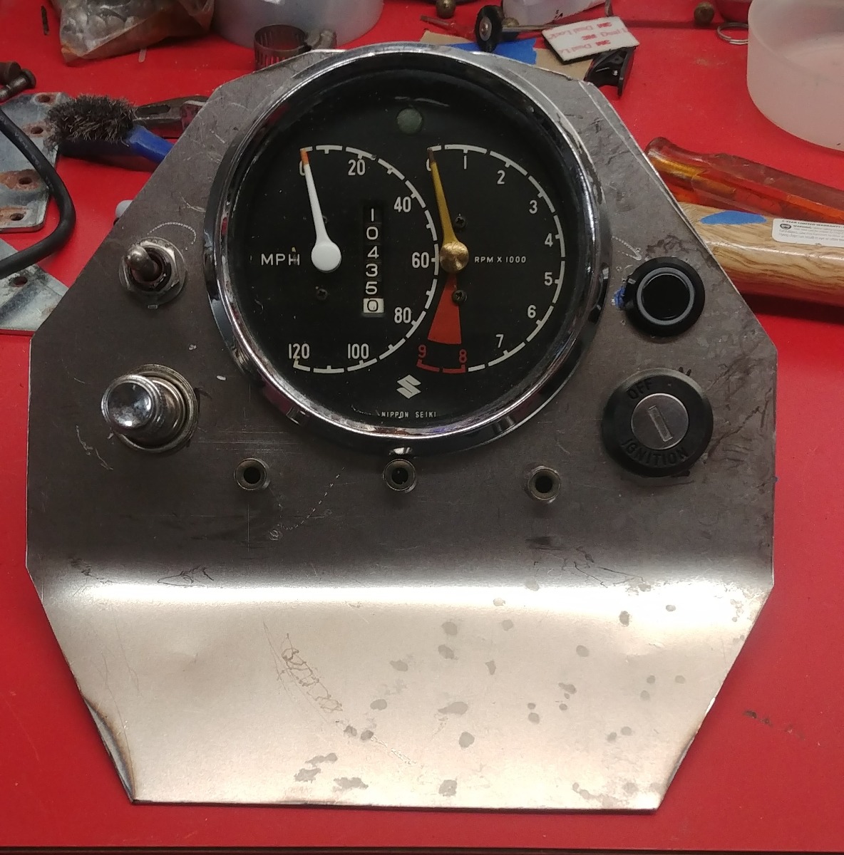

Yes I do have that big bulky switch. I'm replacing it with a universal turn switch. And no I'm not using a car ignition. Here's a picture of the cluster I made with all the headlight switch, power plug (for USB), start button, and ignition.

Cool. What's the toggle switch for?

21 May 2020 09:52
That is the headlight switch. Its an On-Off-On switch.
