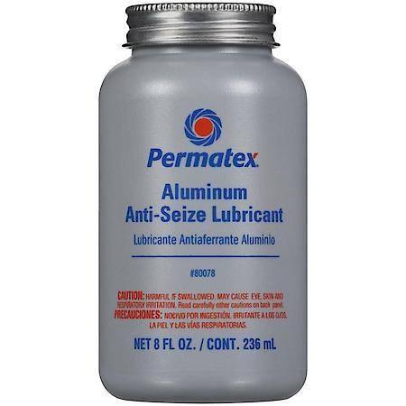

This can will last a lifetime, or actually will probably get passed down to your grandkids.
shop.advanceautoparts.com/p/permatex-ant...AvD_BwE&gclsrc=aw.ds

I actually have some of that in the shop, you better believe those starter bolts will be getting the treatment!
