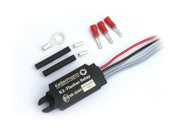

Have to fight with the same Problem on a Honda VT600 with new Moto-Gadget LED turn lights, All 4 turn lights flashes like a Hazard light on L or R Switch position. A simple load/current Independent relay did not the Job and i was a Little brain fucked like what heck is going on here.
The new LED Technology need some new flasher relays. We had to buy the Kellermann Flasher Relay R2 that solve the Problem.
www.kellermann-online.com/en/products/el...lasher-relay-r2?c=70
