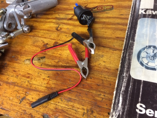

23 Apr 2020 07:51
Sure.
Here is the lead I use. I cut off the clamps and reverse the wires so I can use it to power USBs and a volt meter on the cop bike.
