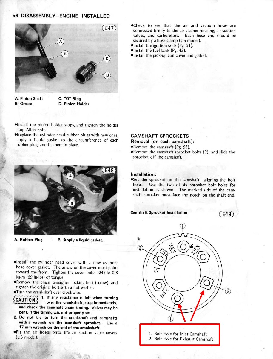

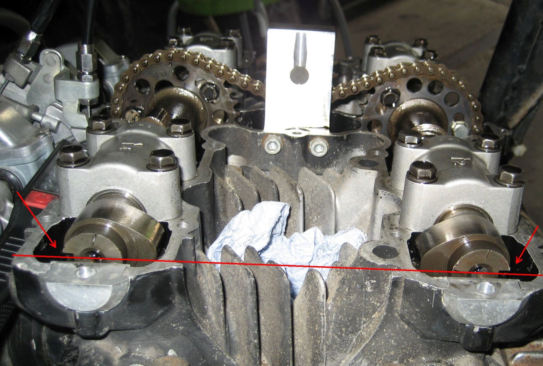

Just an update on the cam situation.
I've taken the cam cover off to check the Mark's are correct at 'T' mark and it seems that I must off accidentally moved the timing points thing when removing the socket spanner so the 'Z7EX' mark on the exhaust cam sprocket is about 10mm above the gasket surface and the inlet cam sprocket 'IN' is 10mm below so as I say I must of accidentally knock it out. Probably needs to be moved 1 tooth along.
So my question is, with it being 10mm out would that stop it from starting??
Any help would be appreciated please.
Oh and just so we are all on the same page my bike is the UK Z750-E1 model.
Thank you

22 Apr 2020 11:43
One tooth out of cam Timing could give you some bent valves if you start the engine.
Cylinder #4 Cam notches position @ piston #1&4 TDC position.

22 Apr 2020 12:38Hips wrote: So my question is, with it being 10mm out would that stop it from starting??
The symptoms you described would be what I would expect if the timing was out. Your valves would have been opening and closing late which means the inlet valve is open for too long on the compression stroke so you won't be getting nearly enough compression.
Also, what scirocco said - although I'm not sure the clearance on the 750 is that tight. You'll want to do a compression test when you've got it sorted just to make sure nothings bent.
