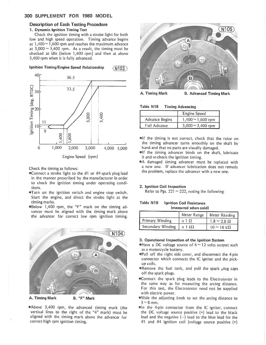

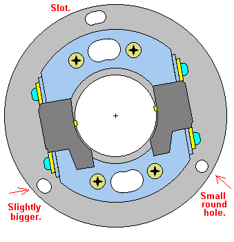

Even though the top hole is a slot, one of the three holes is small and round so is not really adjustable... unless you use a file, of course.
You can disassemble the entire timing plate and clean it etc. The plates are steel, but there are some brass screws that are important. Also, the magnet polarity is critical. Between the plates are two magnets, forming a magnet sandwich. They have to go back with the correct polarity.
Also, when you clean the advancer be aware of two tiny rubber bits that act like cushions. They like to fall off and just look like dirt. It will affect the timing so they need to be there.
Here's a link showing the proper magnet orientation and where the brass screws go, in case you already disassembled it. Note there is a picture showing the rubber bumpers too.
