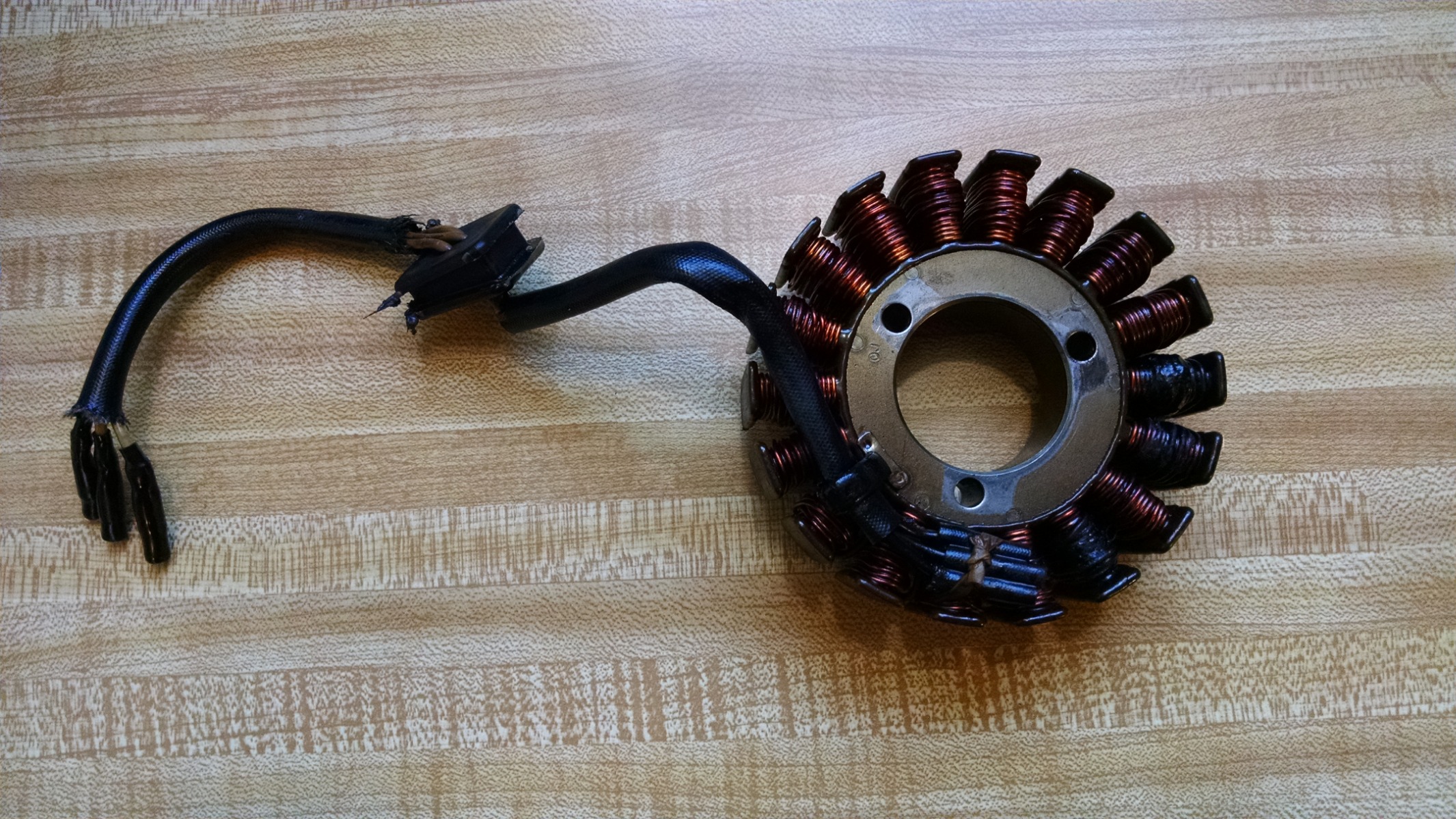

So if the charging system is not up to par, it may need some attention. Check your stator for shorts.

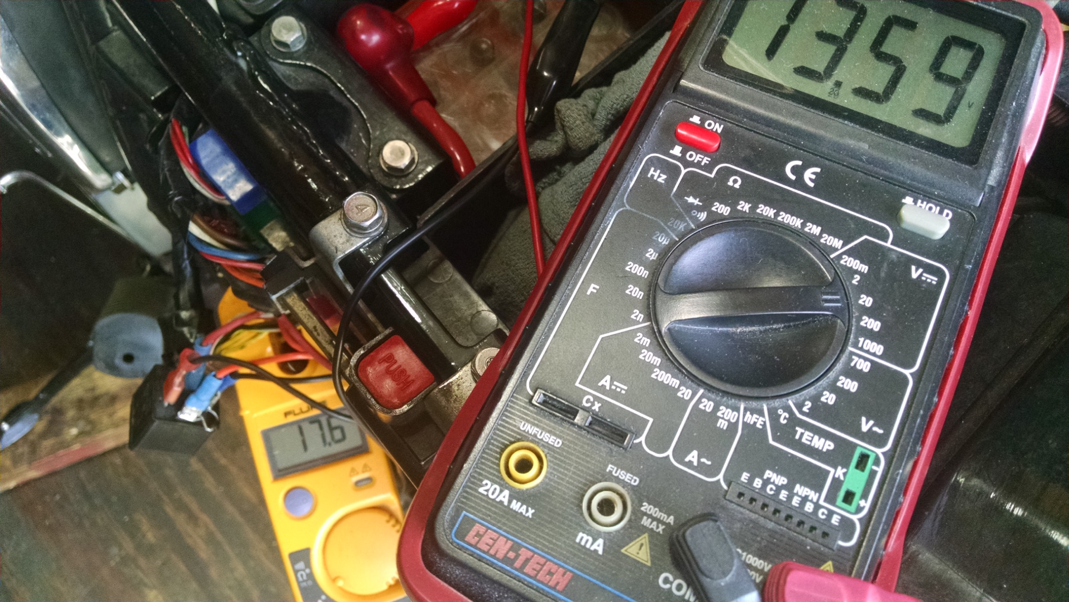

Battery voltage and stator current while the OEM regulator is shunting the excess voltage. This is at 3K rpm on my bike.
