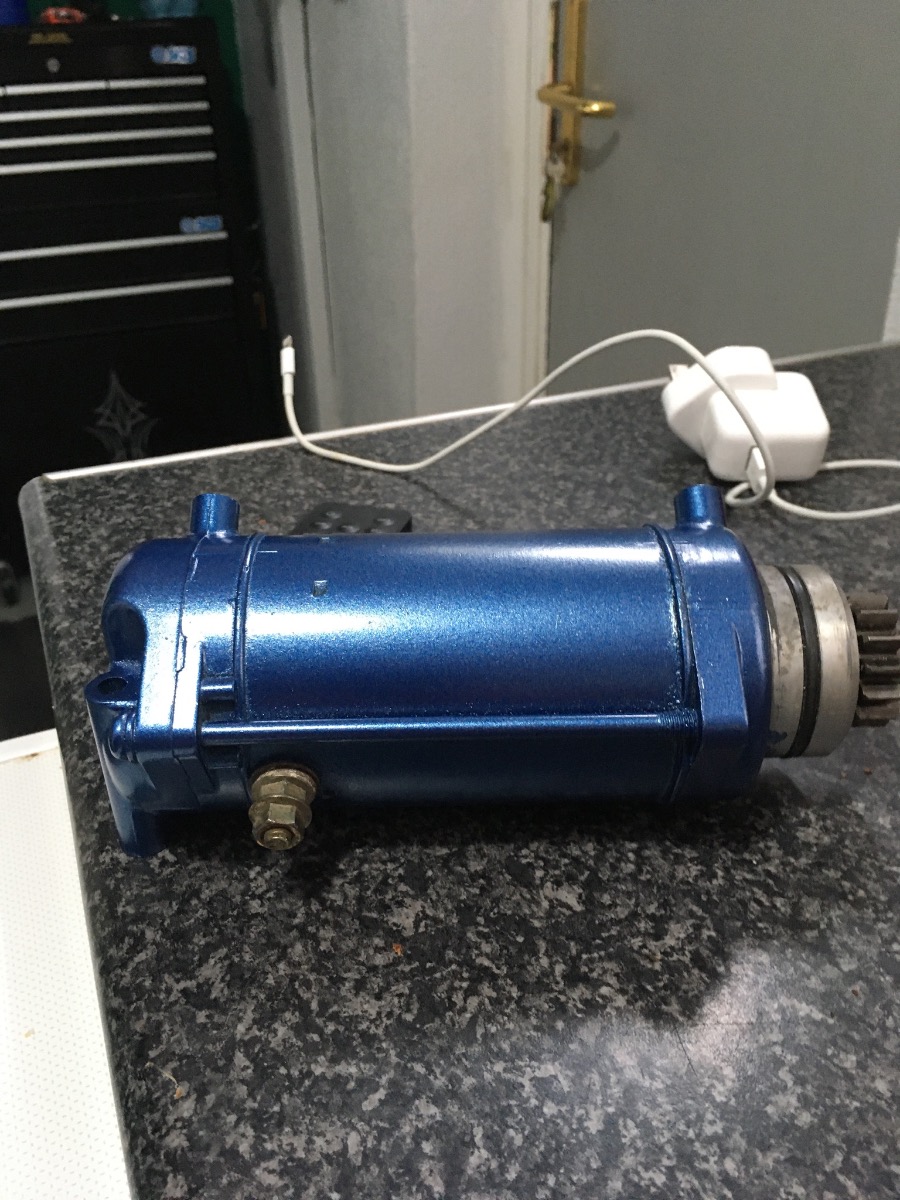

Hi, will a starter from a 750 twin fit a 750 four from the same year if the item looks exactly the same type of fitment? Thanks

Thanks again, it looks as though any motor starting with 21163 will fit all the z650/750. The only difference I’ve experienced is the location of the wiring nut, the replacement I bought has said wiring nut on top of the starter motor and so although it fits on the bike and starts the engine I can’t put the starter cover back on, I need the nut to be located on the side of the starter, I’ve since located one so all should be good.
