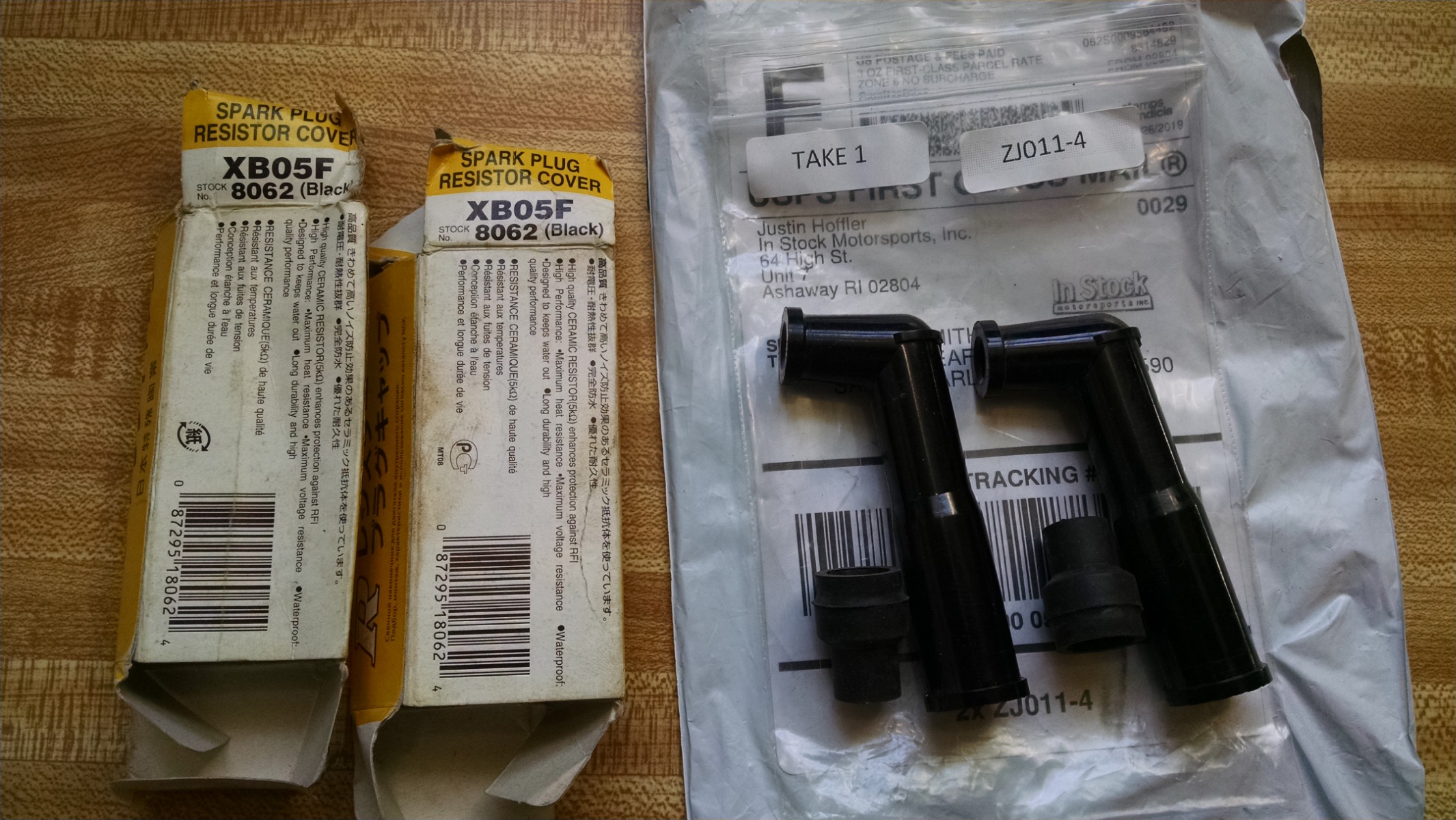

Daveo speaks the truth. Too much resistance will cause arcing internally in the coil. My old kaw uses copper wires with >0< resistance, non resistor plugs, and caps with 5K ohm resistance. Keep in mind that this is a waste spark system. Sooo.. 5K ohms on one plug = 10K ohms secondary resistance on the waste spark coil (2 plug wires).
(I sent these mangled caps missing the rubbers back to the fleabay seller. BTW)

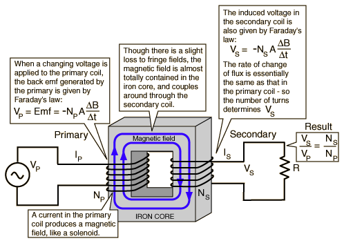

I slightly disagree with the secondary not affecting the primary circuit. A coil is a transformer like any other transformer. Power in = power out.
