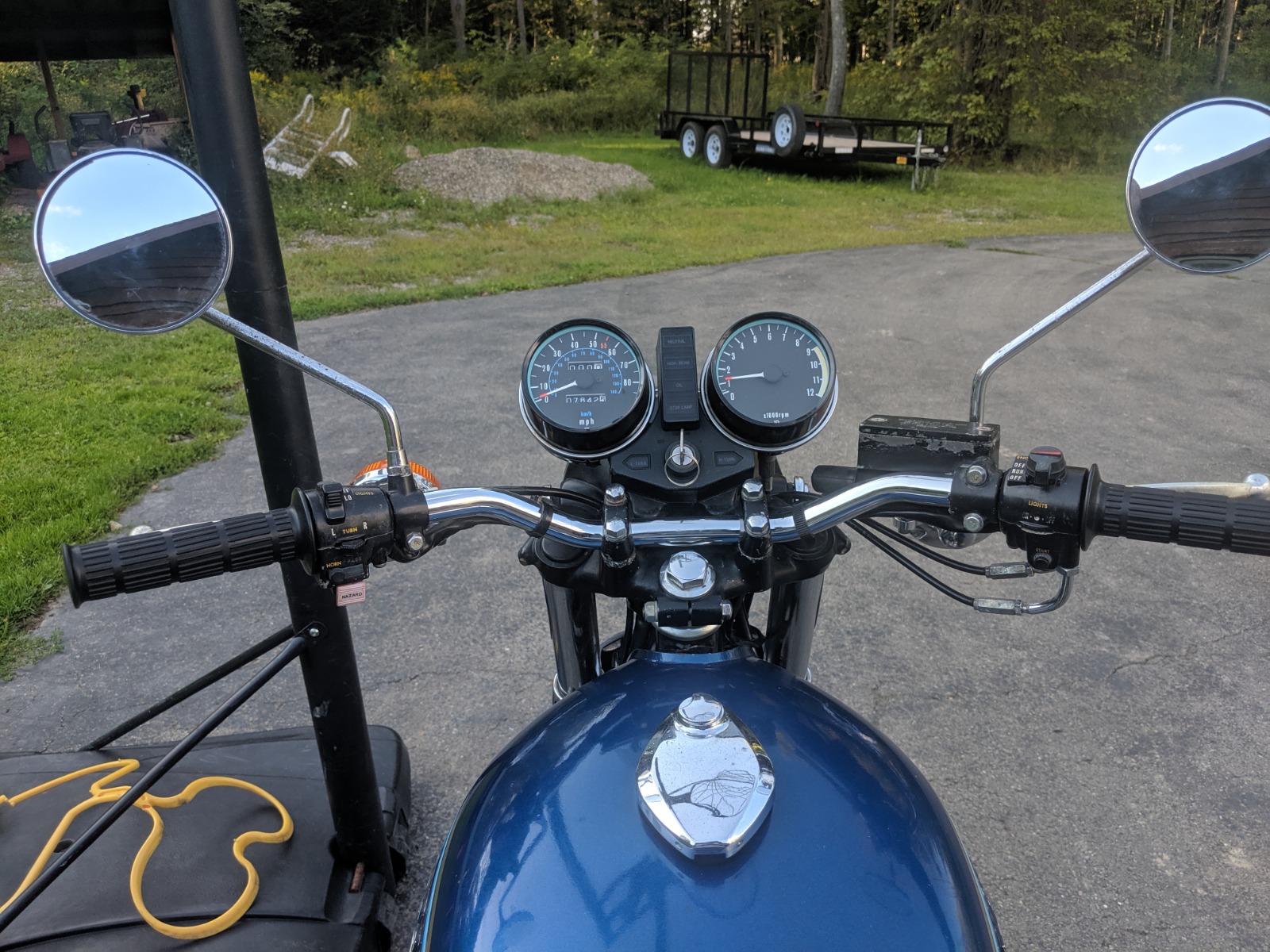

I'm unsure anyone is using KzR anymore but give it a shot anyway, I have an almost fully restored 79kz650 with 7,262 original miles and I was riding it before first snow and my speedometer cable snapped... Not a big problem right? Well I've ordered 3 different cables that said they would fit and none have. All 3 were different styles and lengths too. Anyone know of a cable that 100% fits my bike? That cable is the one and only thing it needs of course
