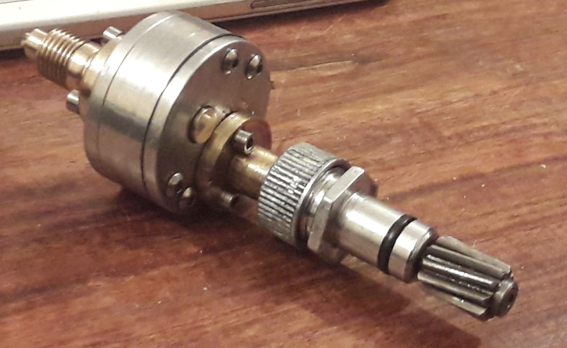

One one particular build I wanted to use a specific tacho which happened to be a Honda analogue item. When I hooked it up it read 1400 rpm when the engine was running at 1000rpm. I was that set on using that particular tacho that I resulted in making an inline reduction gearbox to remedy it.
