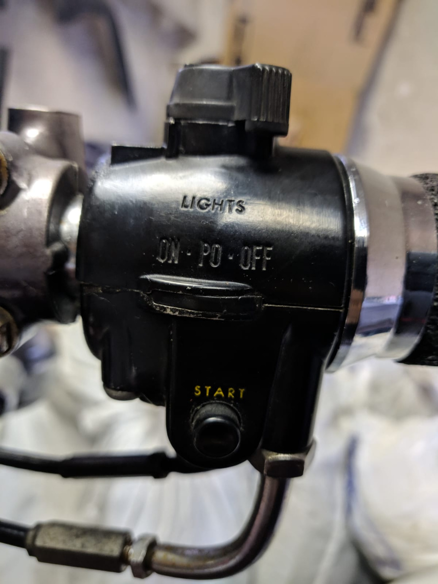

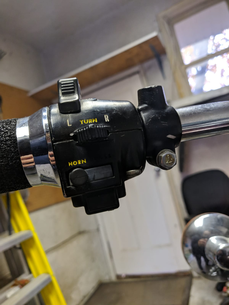

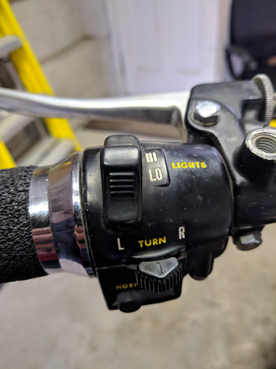

Hey guys, looking for some insight into a weird problem. I seem to be missing a hazard switch where the manual indicates it should be, under the L/R signal switches. Also, my light switch on the right side is sealed where the manual shows I can switch it from ON to OFF. Not so concerned about the lights one as I'm okay with them always on the ON mode but why would I be missing the hazard?

early B1 switches had no hazard swiitch.
The on/off light switch has been sealed by a PO. It never came from the factory like that.

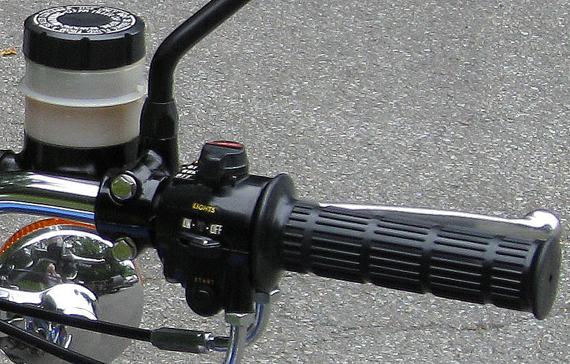

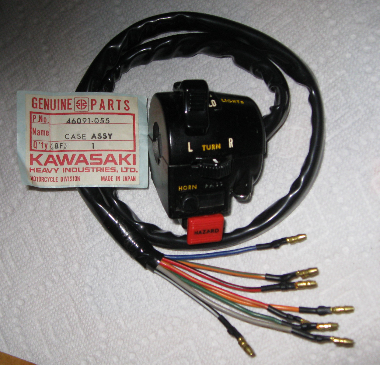

It seems a little strange, but the 1977 KZ650-B1 bikes did not come with the hazard switch while the 1977 KZ650-C1 bikes did. The right hand switch missing the ON/OFF for the headlight appears to be from a later KZ650. The 1977 controls came with the headlight ON/OFF switch but that was deleted on later models. Notice that the words LIGHTS, ON, and OFF are not painted on the switch on your bike; they were painted on the 1977 KZ650-B1 and C1 switch. The images below show the 1977 KZ650-C1 controls. Ed
1977 KZ650-C1 Left Handlebar Controls
1977 KZ650-C1 Right Handlebar Controls

as for the off/on switch , I wanted to have one on my 78 A2A and found out that the wiring harness had the brown wire needed to switch it over, it just wasn't plugged into anything , so I found a 77 control and switched it out, easiest mod ever and now I have the off/on headlights.
I run a halogen headlight and I will turn it off if I'm firing up the bike after it sat for a few days , much easier on the battery IMO
