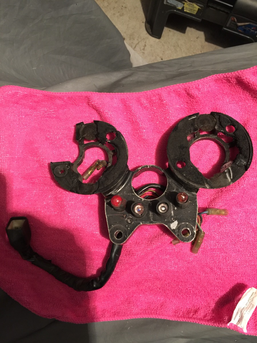

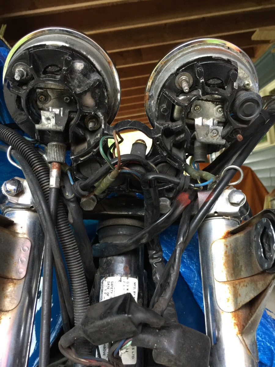

can anyone please guide me on how to replace dash light bulbs on a 1978 KZ1000Z1R, i have removed the fairing already,not sure how to proceed,thanks in advance for any feedback.

I can't speak specifically about the Z1R but on my bikes there is a main plate holding the gauges and the ignition. You need to remove anything that prevents you from getting at your gauges...possibly your headlight and signals. Then remove the gauges. There should be light bulbs in the gauges themselves. Then remove the dash panel to access your dash lights.
The attached photos show the Z1 dash panel from the top side and bottom side. You can see the panel lights in the first photo. The bottom photo shows where the gauges are held on.
