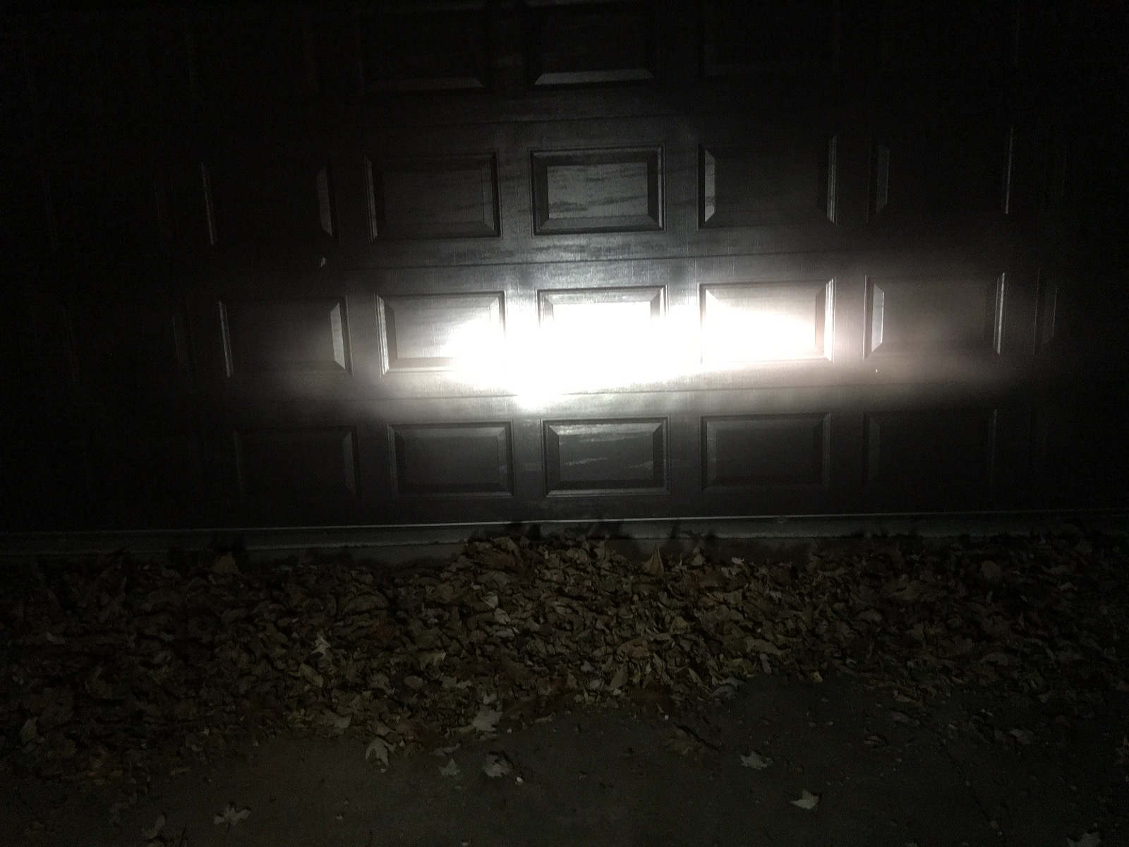

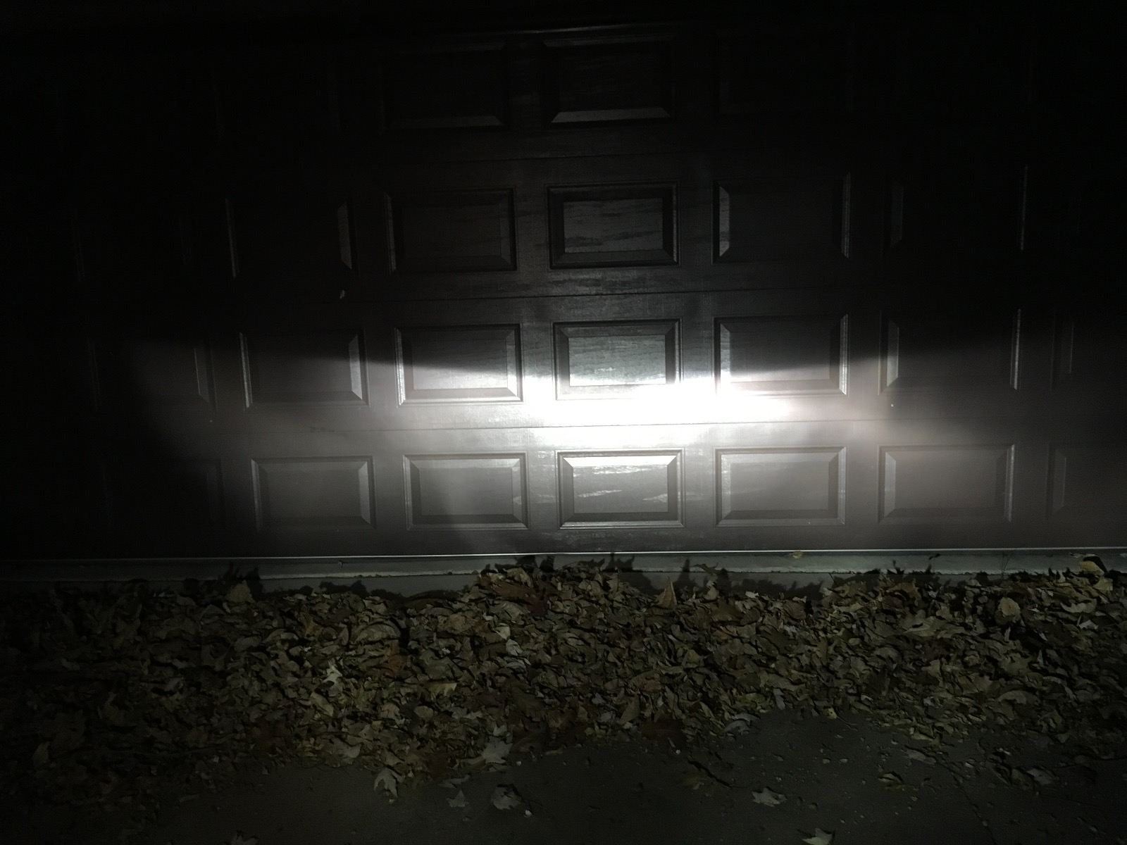

I purchased the same one Steve posted. I don’t have my gauges back yet but I installed the lamp into my halogen carrier and held it in place. Looks like I’m going to be happy. Nice wide beam with a clear cutoff line and a central hotspot on the high beam. Below are pics of it roughly hand held in place . I’ll post better pictures of pattern after the front end is reassembled. Your pattern will 100% depend on the reflective surface of the carrier. Unfortunately I tossed the box but mine was purchased thru Redline Cycle

good pics,
i know you havent had it long, but did it feel quality? feel like it would hold up in the long run?
my biggest concern is that tiny integrated fan, and the fact that it supposedly works well without a ballast.
i guess ill be able to form my own opinion when mine comes in.

If it lasts a year it would be worth the $17. I can hear the fan with the engine off.

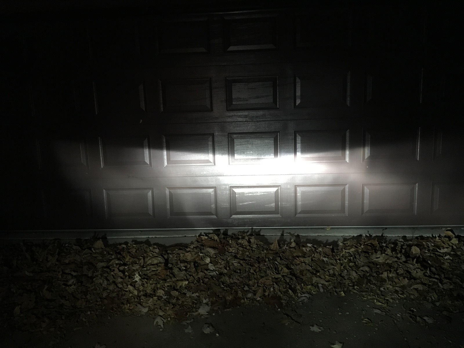

21 Nov 2019 05:54Caleator wrote: ... but the blub seems to work good.
Would like to see L and H beam patterns on a flat surface like Mikaw posted.
