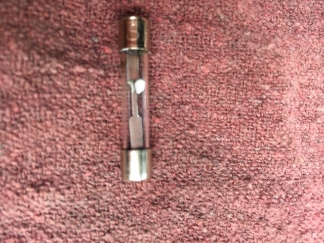

In some cases the melting filament in the glass body get de-solder or corroded on the metall end caps. Visualy the fuse look good but isn´t!!!
The main fuse should have 20 Ampere.

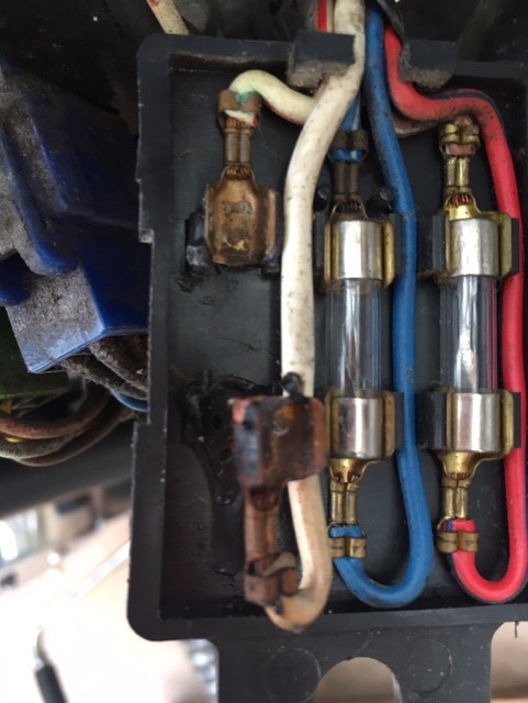

Haven't pulled the tank off in a while and found gas tank had rubbed a hole in wiring harness . Found the label for fuses .Main is 20 amp and lights are 10amp.
Contacts on 20amp were corroded, fuse had popped in the end and not in the middle. Cleaned all under the tank and fuse area.
Added spare 20A fuse too.
Retaped wires and zip tied everything back,bike fired right up.

Yup, that will cause some low-voltage issues at the coil and regulator. The regulator tries to compensate by raising the battery voltage too high which also shortens the life of the battery. The mini-blade type are a lot better.

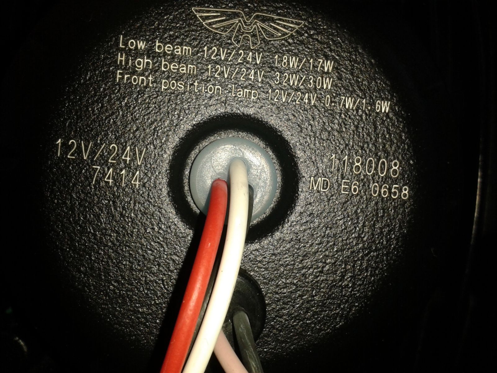

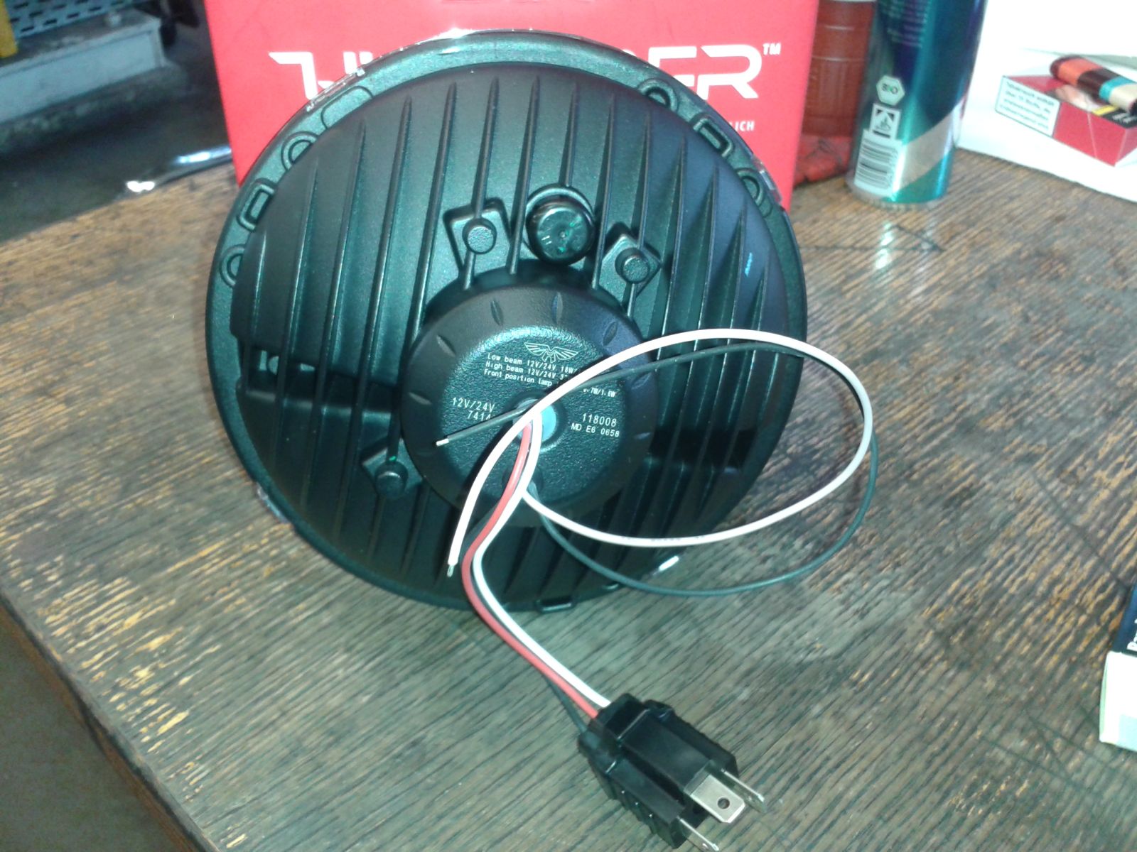

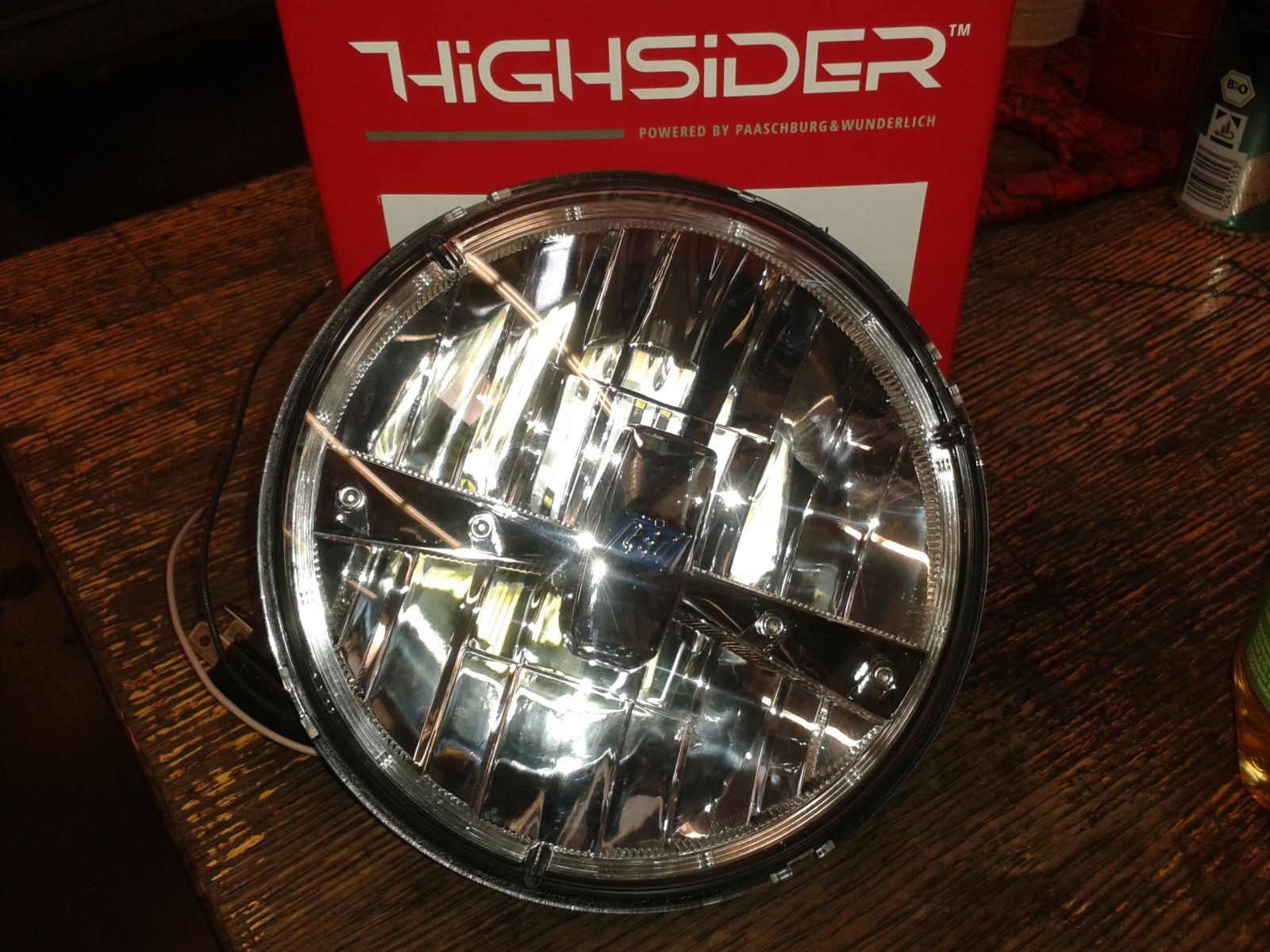

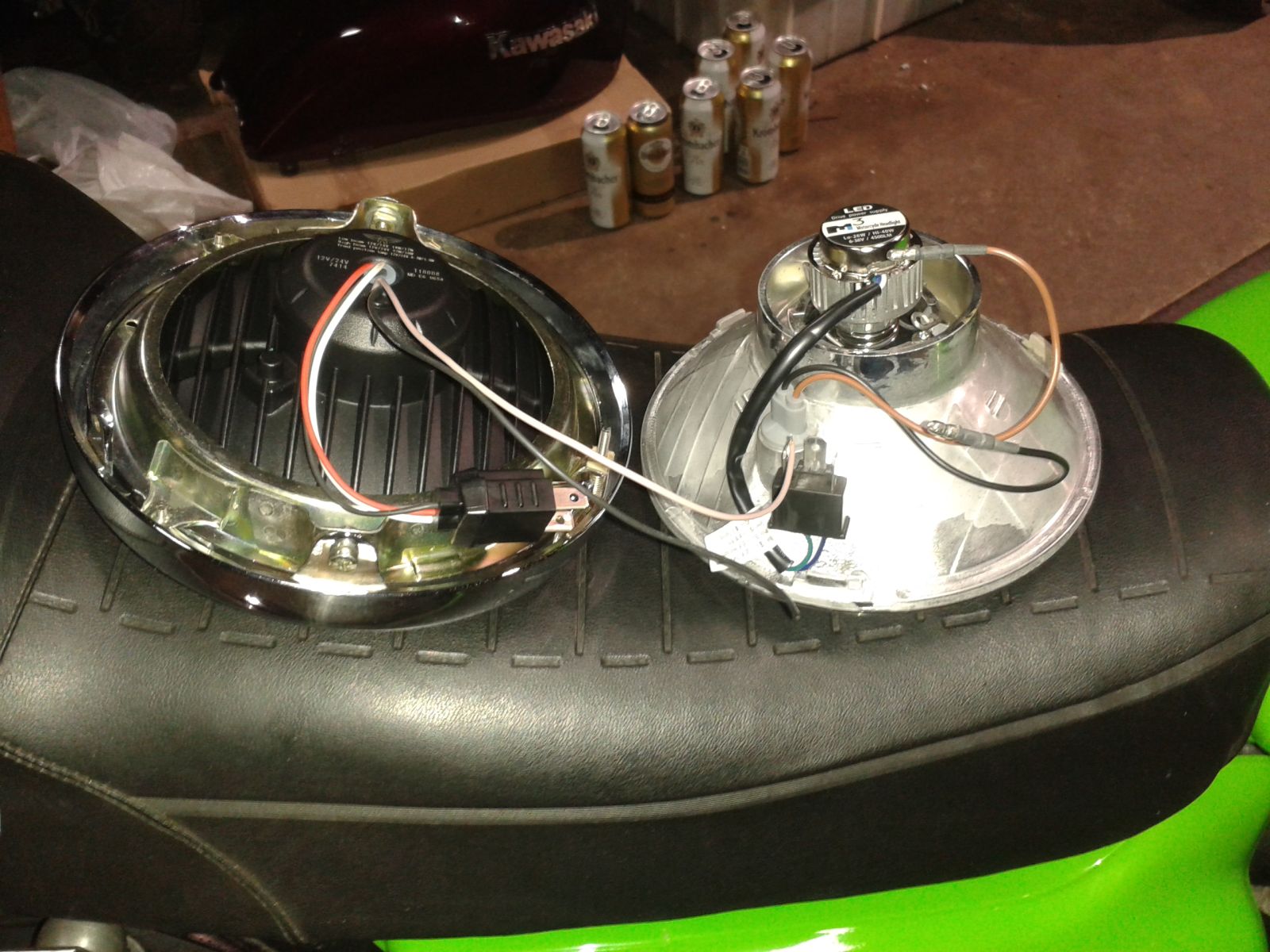

Just a Little hint. The Highsider 3 LED insret will fit plug and play into the head light reflector frame!!!
Re: KZ900 stopped electrically
07 Oct 2019 16:12
Scirocco who’s I would have known that 2 months ago. I just installed the halogen carrier and not happy with the light output. It came with a 60/55 H4 bulb. Seams kinda dim. Not much brighter than the Stanley sealed beam
