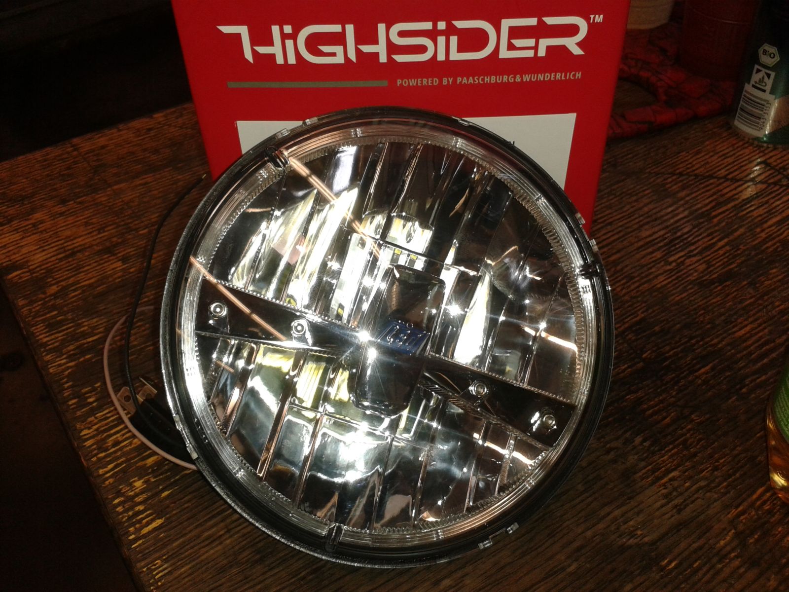

So as I am working through a custom build on my old kz550, my last immediate mod is the headlight/turn signal upgrade. The tail light and rear signals are led already so I want to get an LED set up for the front as well.
This will be on light off road duty frequently so having signals that stick out much are not a good idea. I have seen some of the LED combo headlights on ebay/amazon. Just curious if anyone has experience with these.
Also, having a 7" glass headlight presently, I assume that I would just remove that and install the new LED assembly.
I have installed several H4 Cyclops LED bulbs in various bikes and love those. However, if I can delete protruding turn signals in the front (like I did in the back) altogether, that would be ideal.

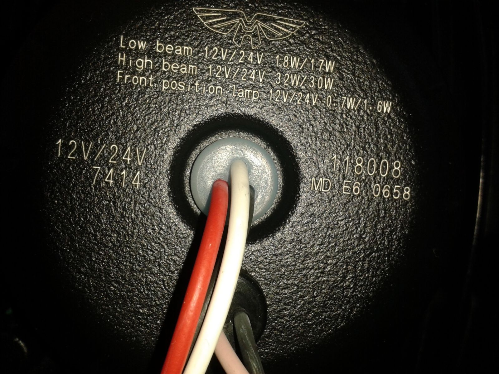

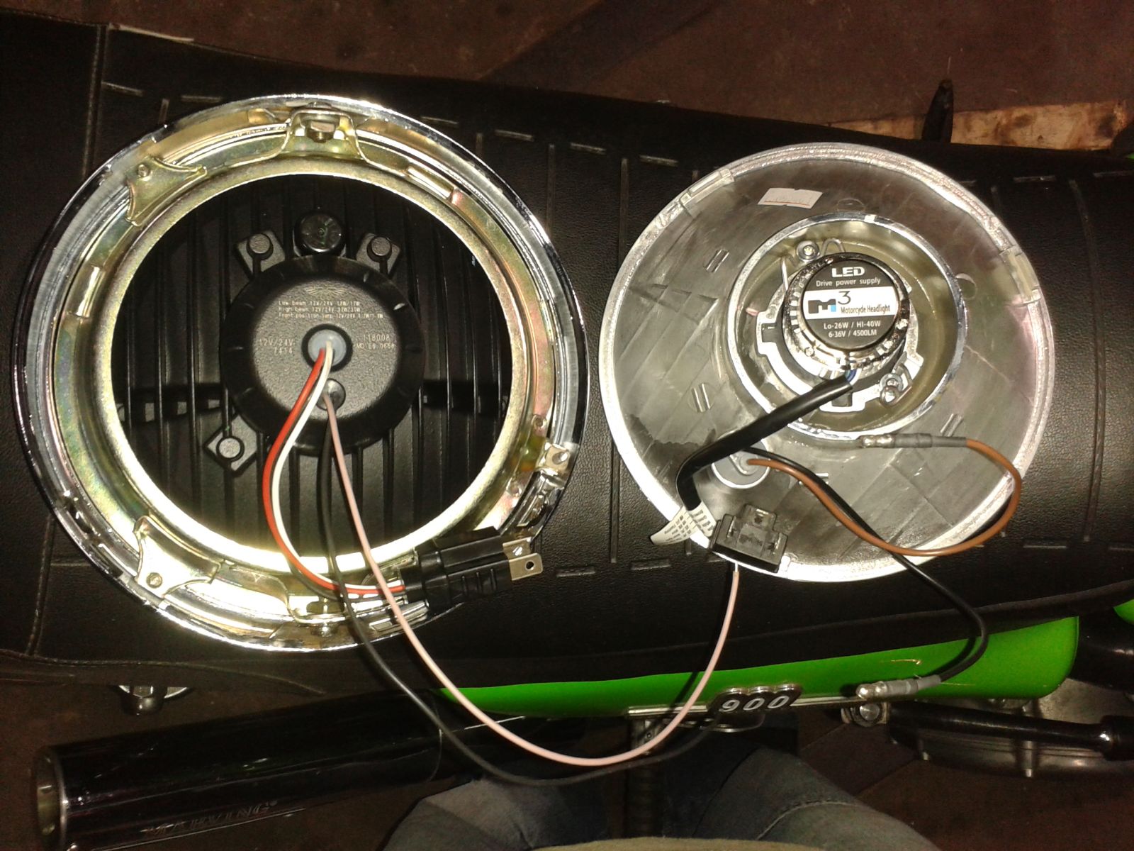

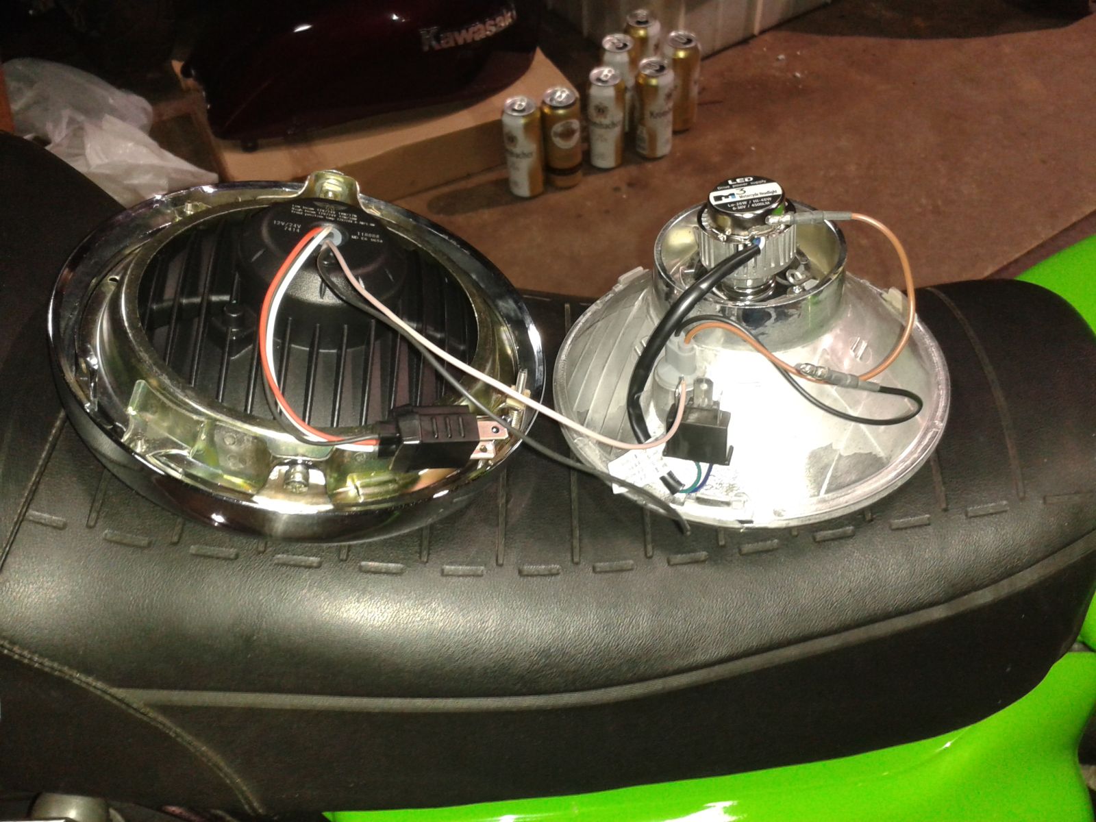

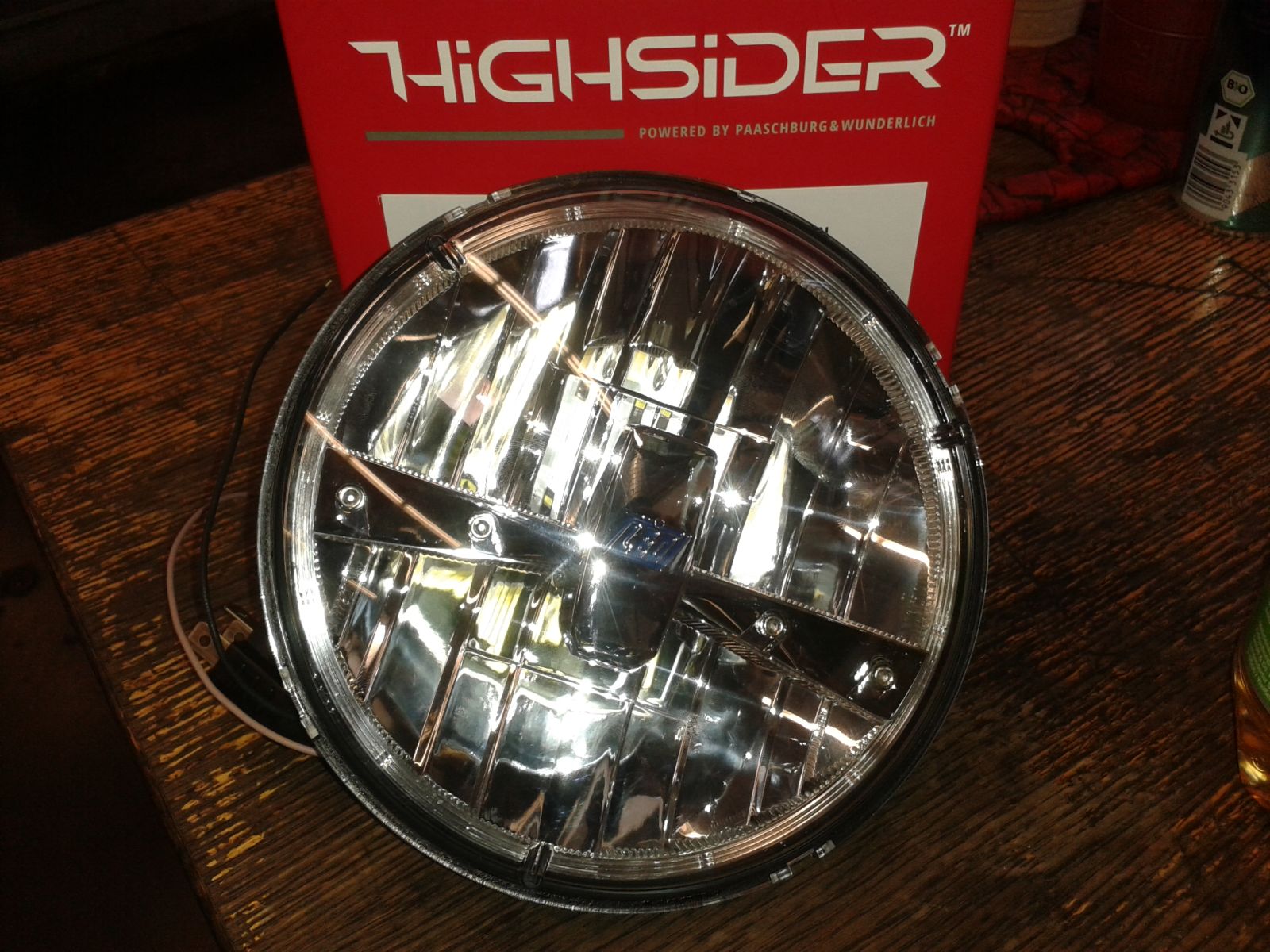

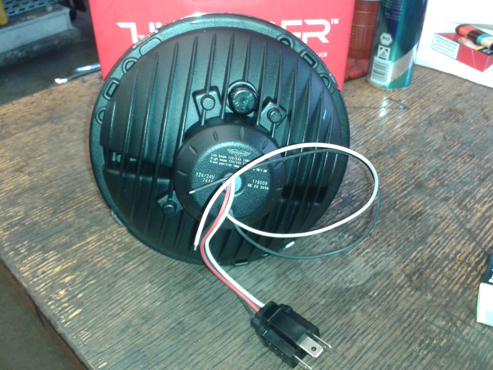

I just did a LED head light conversion. Got a highsider 3 LED assembly for 120 Euro last year. It was a 15 minutes plug and play job . Fits in the 7" Z1 head light reflector frame with no problems. Change my new reflector with the LED bulb and switch to the highsider 3 LED assembly.
