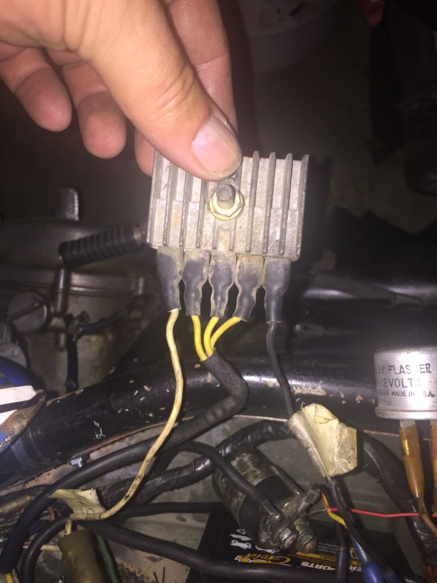

Pics of what you have?

Here is the picture of the culprit . Hope it helps.

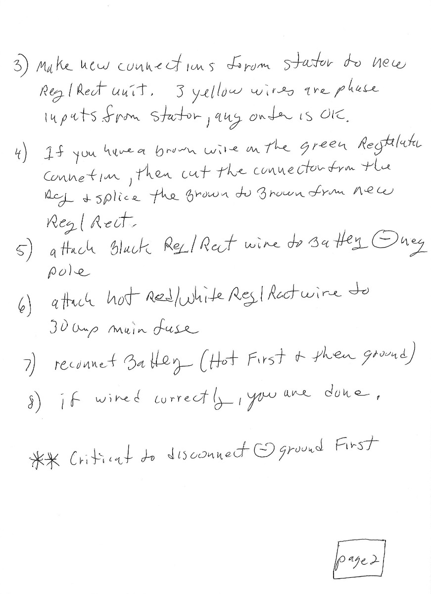

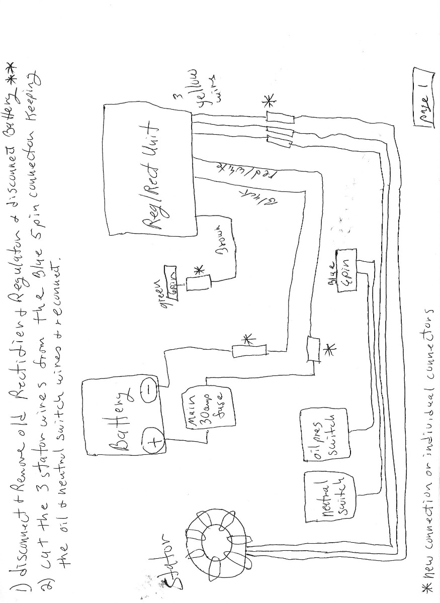

- Posts: 23784
- Thanks: 3048
Re: rectifier problems
07 Aug 2019 19:08
- loudhvx
