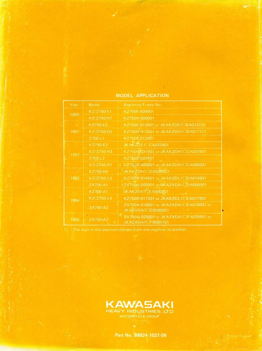

Re: 81kz750 ltd
07 Jul 2019 13:20
Here you will find a better quality scan of the full Service Manual.
www.750turbo.com/manuals/GPz750_Base%20Manual.pdf

Re: 81kz750 ltd
08 Jul 2019 15:08
The manual Scirocco linked is a good pdf w color wiring diagrams & covers the chain drive models thru 1985.
