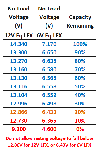

Check the manual for whatever battery you have. Resting voltage on a lithium phosphate battery can be as high as 14.4 or so. This is the chart from shorai

Thank you for this. Really appreciate it.
