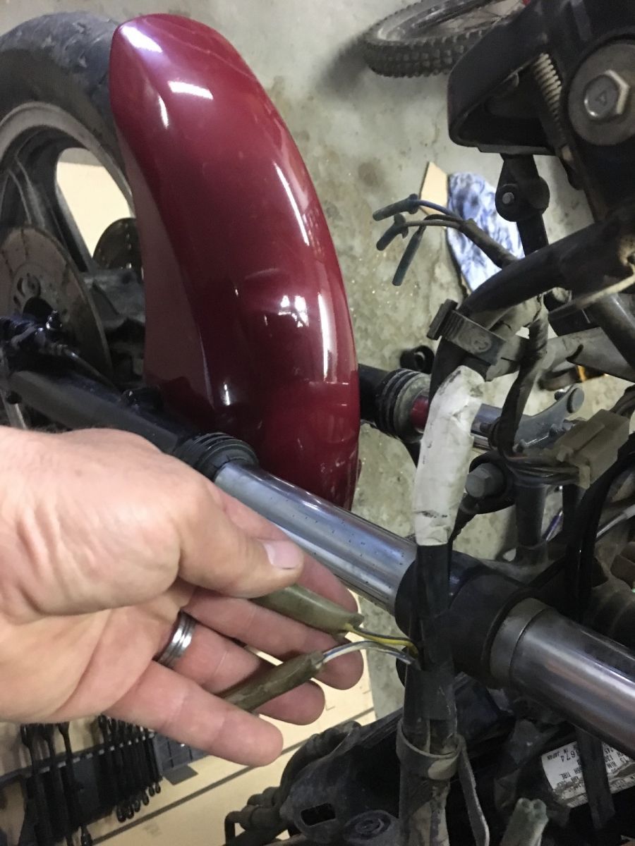

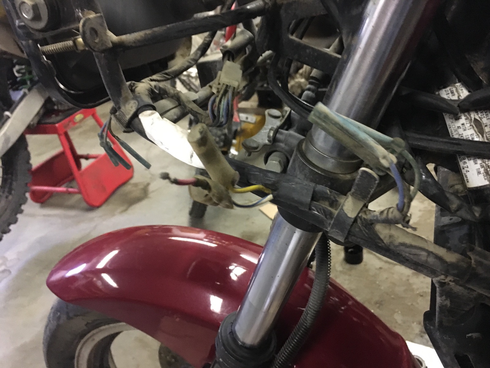

Title says it all, left side by the signal light wiring.

Probably an accessory power wire (blue-white) & accessory ground (black-yellow). They usually terminate in the headlight bucket & the accessory leads typically have large protective covers like the ones in the pic.

That sounds about right. The colours are the same as one beam of the head light.
Looks like whatever was there is long gone now. Probably a goog spot for a phone charger or gps...
Thanks

Meat-head wrote: Title says it all, left side by the signal light wiring.
Same as the ?? wires in the bucket of my KZ440, do they have connectors for 2 males in each ?

Yes, there is a double large gauge female connector in each.
I should have checked to see if it is only powered when the ignition is on.

The wiring diagram shows double female terminals for the accessories.
Wiring diagrams. mbsween. bike-night. KZ750L3. Scroll down & click "The Bible" link.
note: some of the diagrams are mislabeled in the links: the 1981 Ltd is an H2, the 82 is an H3, & the 83 is an H4.
