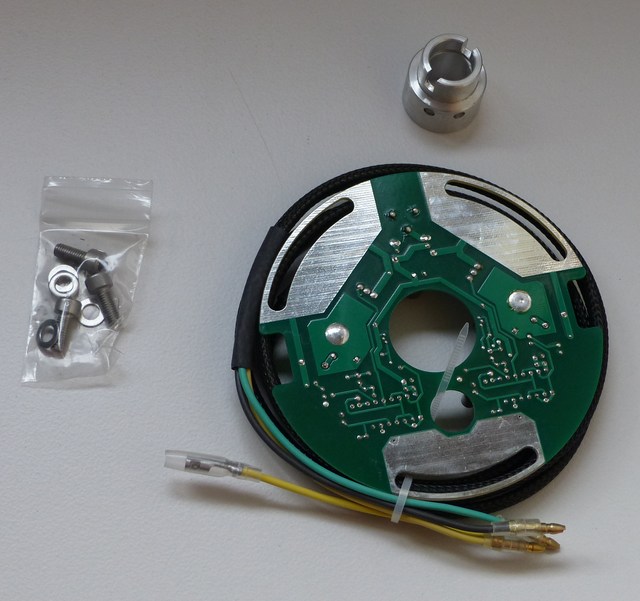

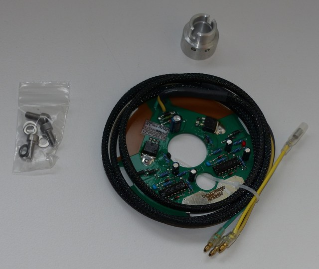

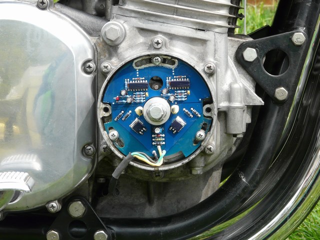

The Accent ELZ2Coil is an electronic ignition System for classic Japanese bikes made in Germany.
It works with stock and aftermaket 3 ohm coils. It has an auto off feature (3 sec. off no idle) and includes an LED (the small red dot toward the middle of the board in the photos below) for static timing (F mark) and longer adjustment slots. Price is 170 Euro.
