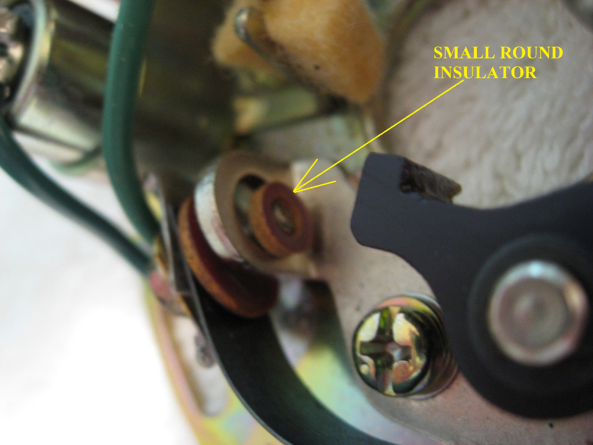

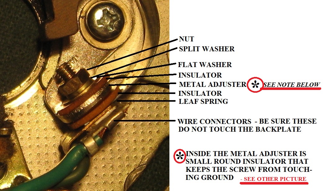

First at all, remove ALL parts of your ignition and give them a good clean with a brass brush.
The ignition timing advancer looks like totally corroded/locked and need some grease to do his work correctly.
Check the Points are intalled correctly.
