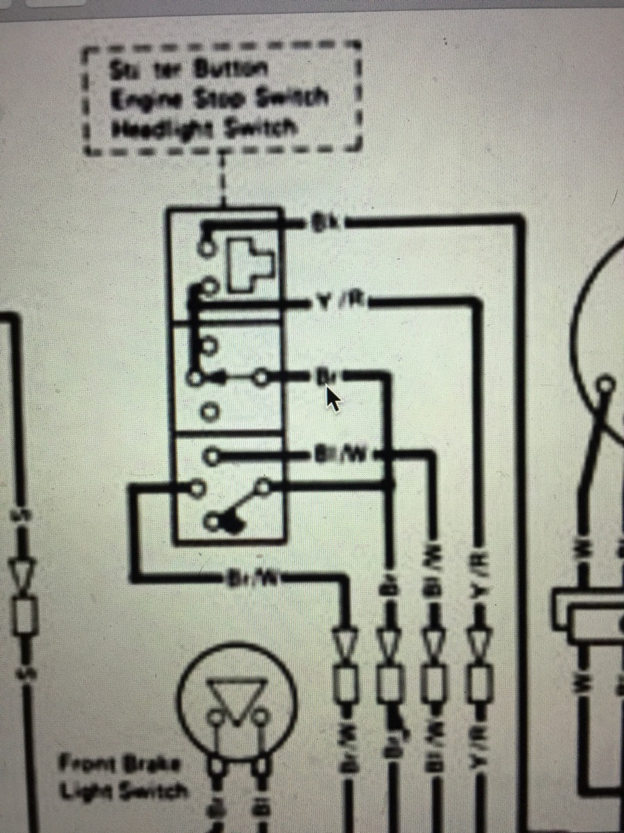

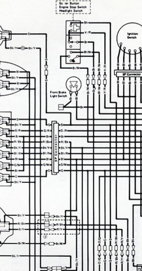

This is the wiring for an A1. It's probably the same as yours. Blue and Brown are both hot wires.
