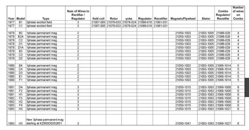

It would help if you put your bike's exact year & model in your signature line. Kawasaki used 5 different charging system on various KZ650 models / years. Some of those charging systems worked better than others with electronic ignition systems. Ed

I understand that you were not asking about the charging systems. However, the charging system provides power to the ignition system, and certain charging systems may not supply enough ooomph to enable the ignition system to operate properly. Unfortunately, your 1978 KZ650 has a charging system that may not work particularly well with some electronic ignition systems. The 1978 K650 charging system is a single phase system, and a number of folks have complained that while is will work with some electronic ignition systems it may not work very well with others. If you do not receive some feedback from folks who have done this switch you may want to post again with the question as the title or you may want to post the question on KZ650INFO. There are folks there who are very knowledgeable about the various systems. Ed
