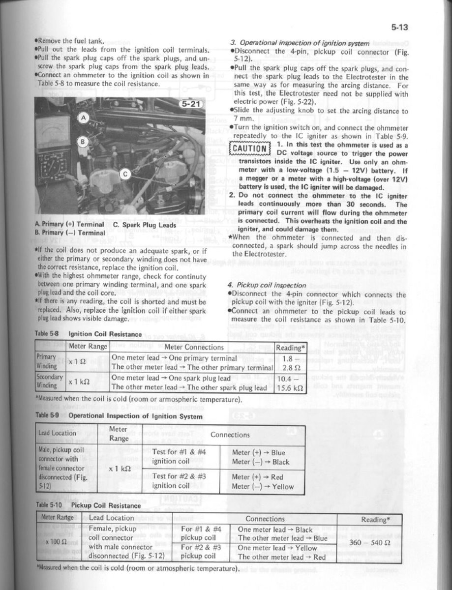

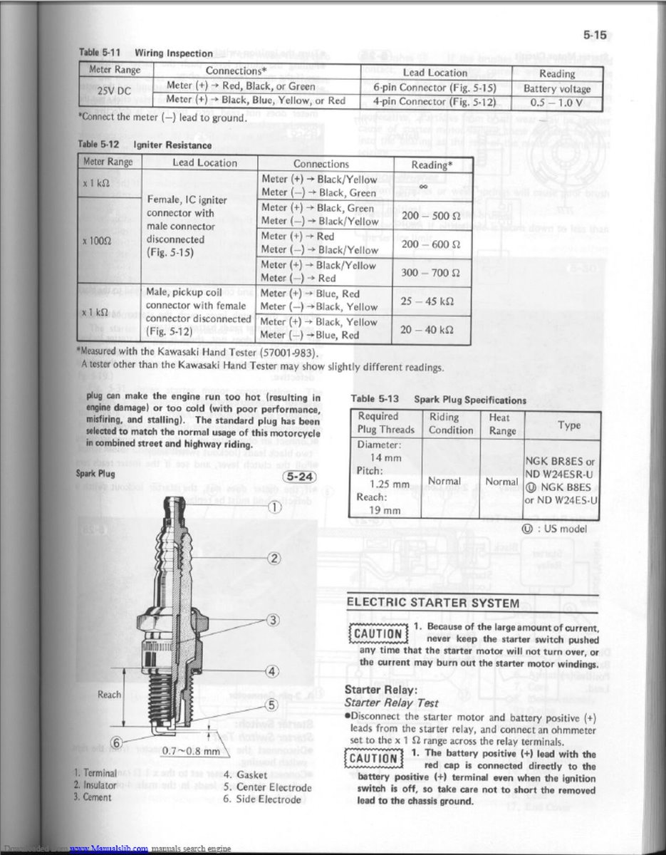

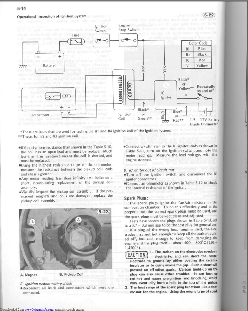

Download the Service Manual Marty.
It´s a great source for your bike related questions.
www.kzrider.com/modules/ServiceManuals/K...Service%20Manual.pdf
