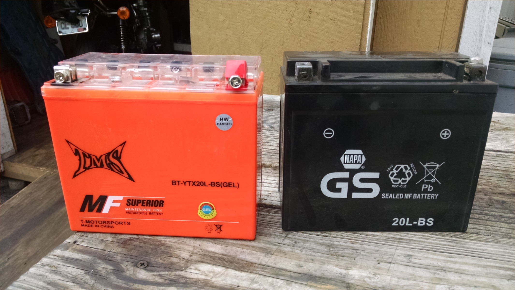

I went to Advance Auto Parts on your recommendation and had the battery load tested...the cold cranking amps were half of what they were supposed to be, at around 80. The new batteries are supposed to be 160, so I went ahead and got a brand new one. The starter seems a little more eager to engage but there is still a slight delay sometimes. Also, the horn hasn't changed a bit...still completely weak.
So I bought some alligator clips and jumpered the battery directly to the horn. She beeps...loud, crisp and clear.
Maybe I missed a ground somewhere? Everything else on the bike works.
